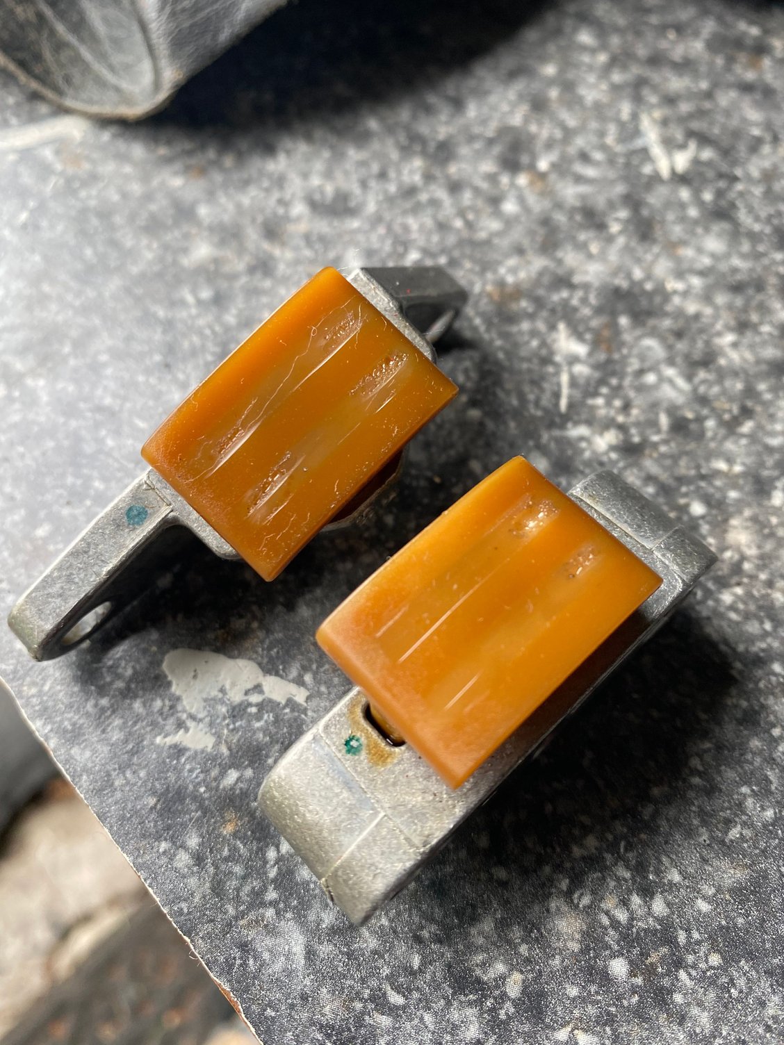

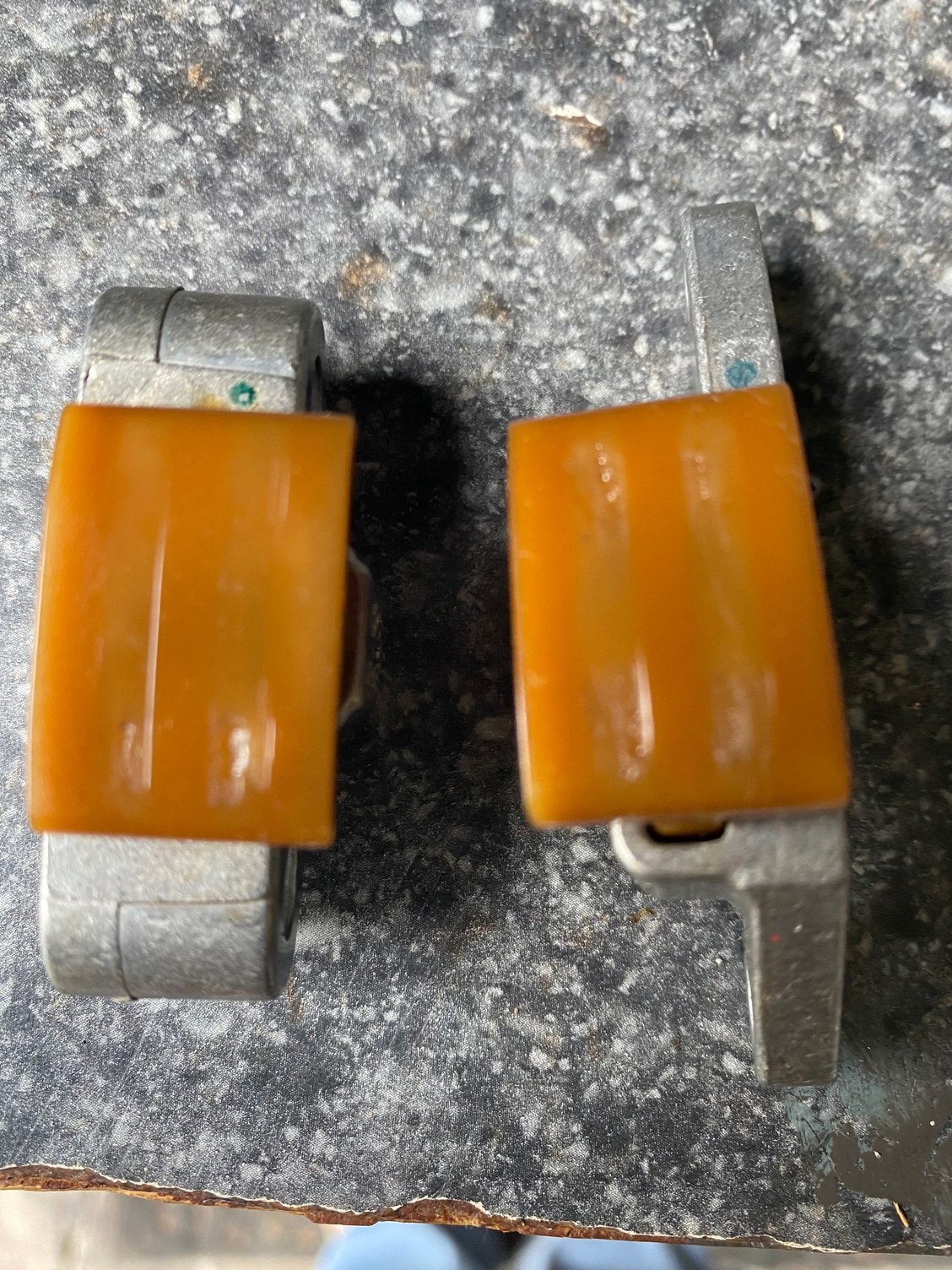

Everything installed and running great. Here’s a picture of my cam tensioner pads that came out with 34,000 miles on them.

Normal, with beaucoup' life left in them.
