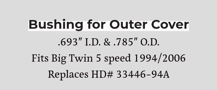

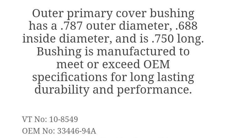

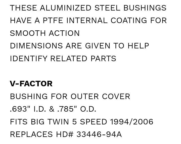

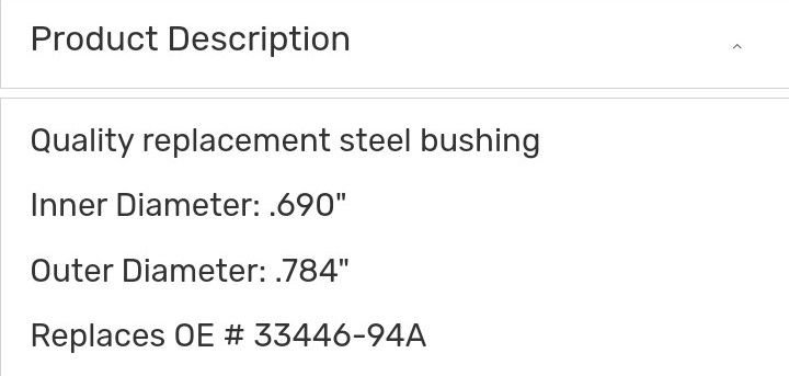

Originally Posted by MotoJockey
Those dimensions are WAY too big for part #20.......
Below are the dimensions from a few different aftermarket suppliers.
Good info Barney....... I thought part #20 was the dowel type bushing to help hold the gasket in place. I forgot about the bushing in the outer primary case for the starter shaft.
