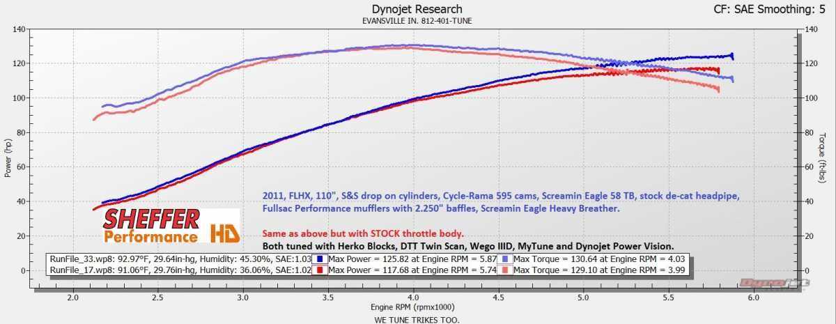

Here’s a 103-head 110 combo with a decat pipe, wfo Larry heads and cyclerama 595, stock TB vs 58mm. Personally I’d save up the $$ and do a 113 build with Ward cnc porting the 110 heads but a build like this would pull hard for the $$

Thanks for the feedback. Good looking run. A 113 build will have to be a winter 24/25 project since riding season is upon us already here in TN. Now to find a good shop near to Memphis. I did find a pair of LC 103" heads (6K miles) for $300 which I may buy and send off for porting and milling. I can do the head r/r and cam/bearing/lifter/pushrod install.

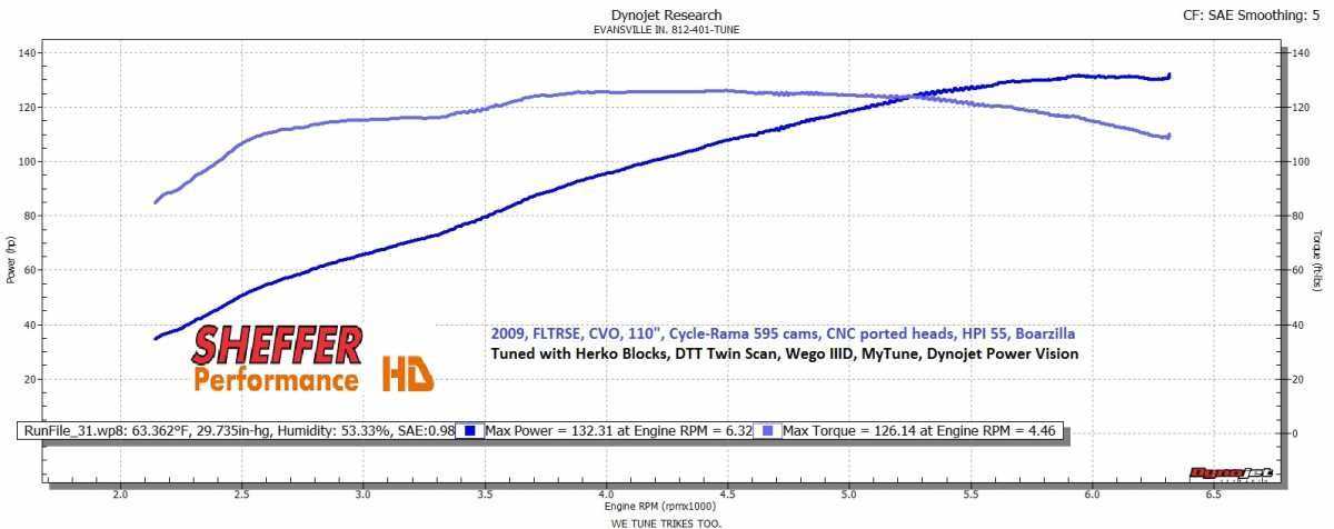

Or you can get 10.5 pistons from HD and run the 110 heads stock. Not sure what cam would be best but here’s one with t-man’s older 625
