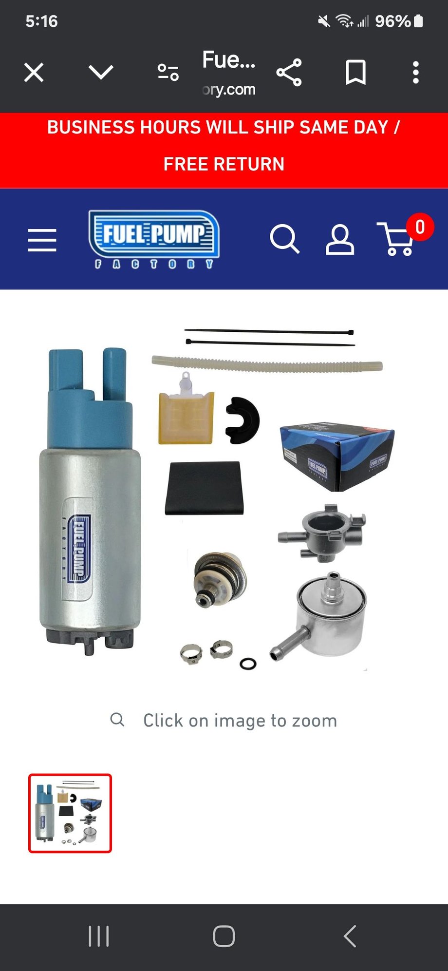

Convinced the tank fuel connector is not the issue. Fuel pressure tester is ordered; delivery by the end of the week.
Question: Even though the pump is priming; fuel pressure could still be the issue? So if pulling the guts from the tank, replace fuel pump; filter; top plate gasket;regulator and all the connecting lines/clamps? Assuming all OEM replacements unless someone has acceptable aftermarket replacements.
I will be looking for tips/tricks; do'/dont's for the fuel system R/R. I have done the R/R on my old FLHT to adjust the float level but did not replace any components.
I have used fuel pump factory in the past for replacement parts, Super fast shipping and good customer service.

Thanks to everyone. It only took five days to figure out I have a fuel delivery problem; that's on me. Hope I can move faster once we know if fuel pressure is the root cause. Tool should be here by the end of the week; I should be able to post test results by the end of the week.
Got parts list together; $150 mas o menos. Thanks Mr Buell, I will check out the fuel pump factory.
