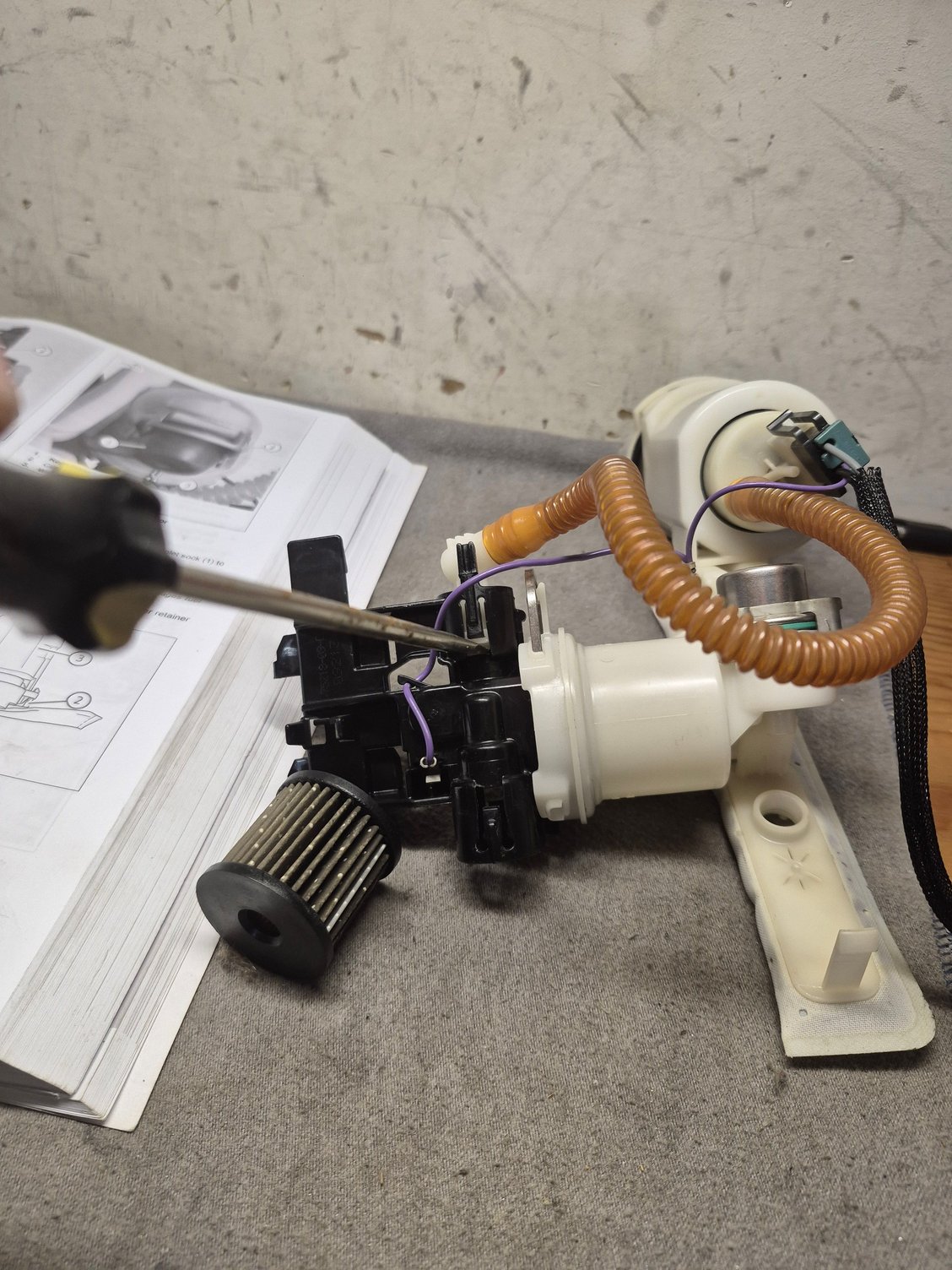

Pulling the pump is very simple. there's a tab on the sliding bracket on tunnel of the tank. You push down on the rear tab and slide the complete assembly forward. The only fuel line you need to remove is the one toward the rear that goes to the quick coupler fuel line to the injectors. You do need to twist and turn and the tip to the right and then move the entire assembly toward the rear of the tank.. It can be a pita so just take your time.. I would remove the rear fuel line before removing the assembly from the mount.. When I disconnected the fuel line I compressed the 2 clip but then had to put a #1 flat blade screw driver in the small gap between the fuel line and the pump housing and with a slight twist the fuel line did sperate from the housing as shown in the pics below.. At this point I would replace the pump and regulator.. I would also replace the filter and the sock down on the bottom I just got a kit from Amazon should be here Friday. Only 20 bucks.. hope this helps..
Don't mind the fuel line I have connected to the pressure side outlet of the pump I only use that as a demonstration, Also the third picture I'm pointing to the regulator..

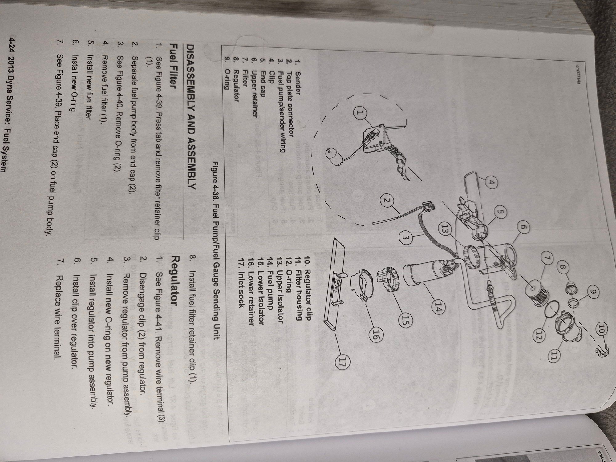

@98hotrodfatboy Thanks for the detail, the link and the pics. I can't really see the release tab but I know where to look. What clamp is used to connect the line from the quick disconnect to the fuel pump? What connector do you plan to use to connect the new line? Most OEM clamps are Oetiker and I plan to use PN 10222 which looks like an Oetiker clamp in the parts manual.

I should've researched a little better.. your setup is different than mine. Yes you will need the oetiker clamps. Newer version are a lot different. Mine are quick disconnects.. Sorry if I steared you in the wrong direction..
