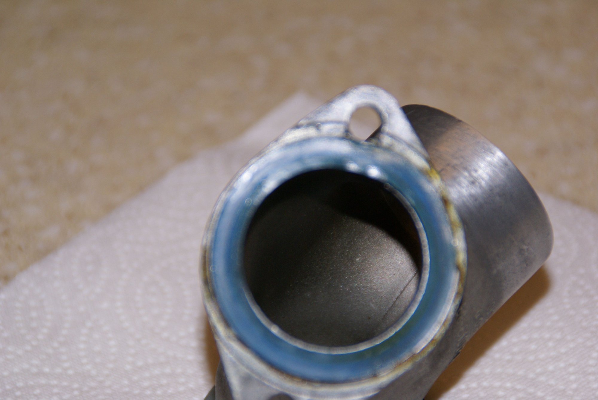

I finally got a chance to get back into it today before heading to work tonight. The pics below are the new seals that I put in alst week and were still leaking. I went to my Indy Pro Twin Performance and picked up a set of Cometic intake gaskets. Kevin also planed the intake flanges for me so they were flat. Put it all back together and also replaced the carb spigot gasket.

the blue seals are a china replacement i never use them we just throw them away - OEM or james are good quality
Those blue seals were James silicone gaskets.

the china stuff i have seen are blue someone should tell james they are color copying a product they make
