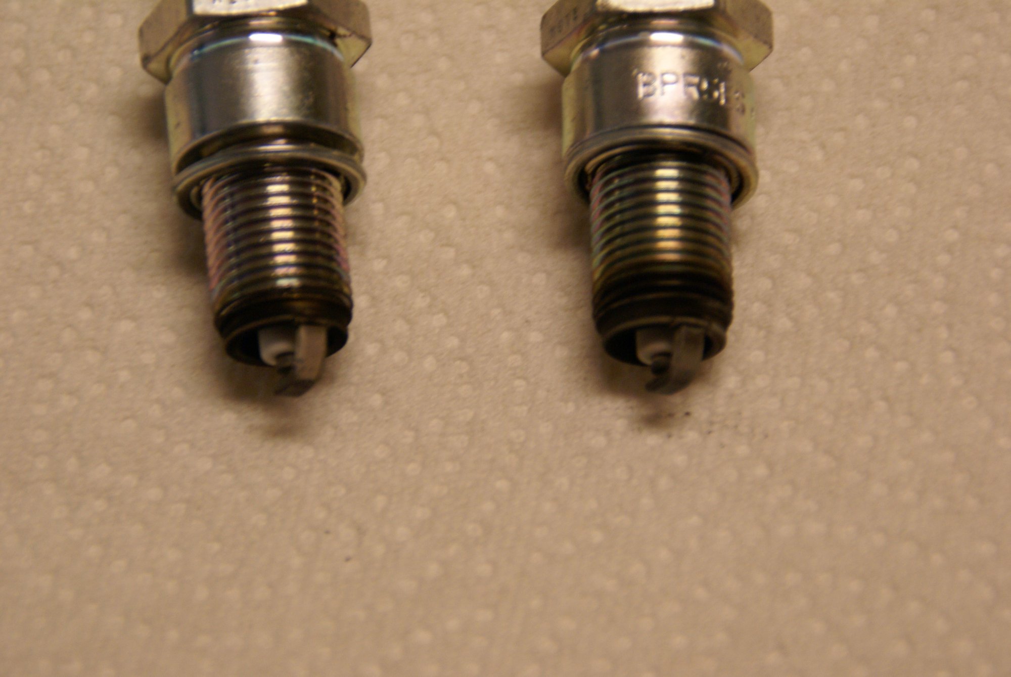

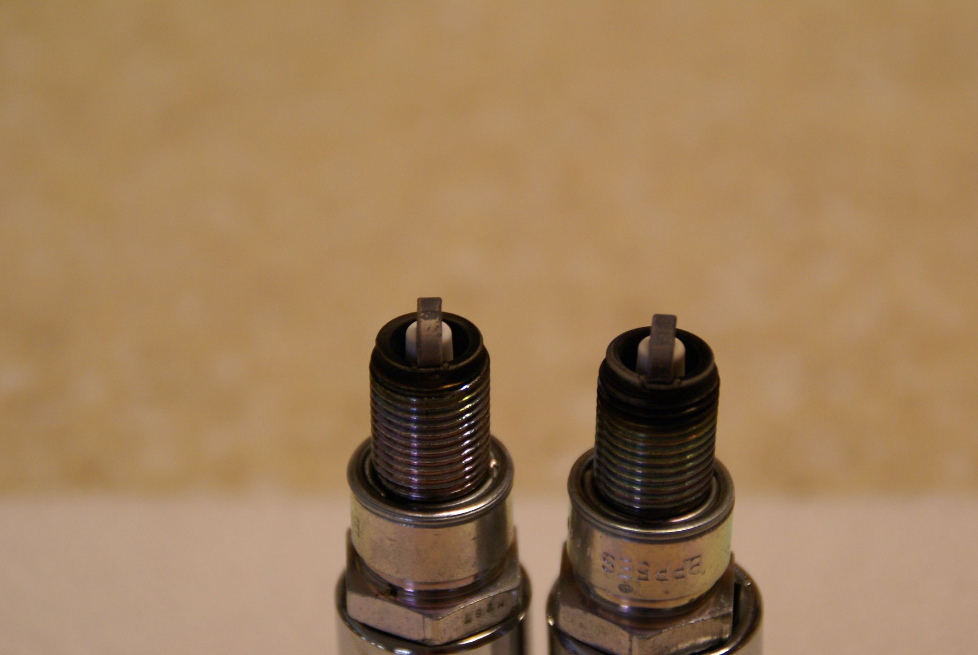

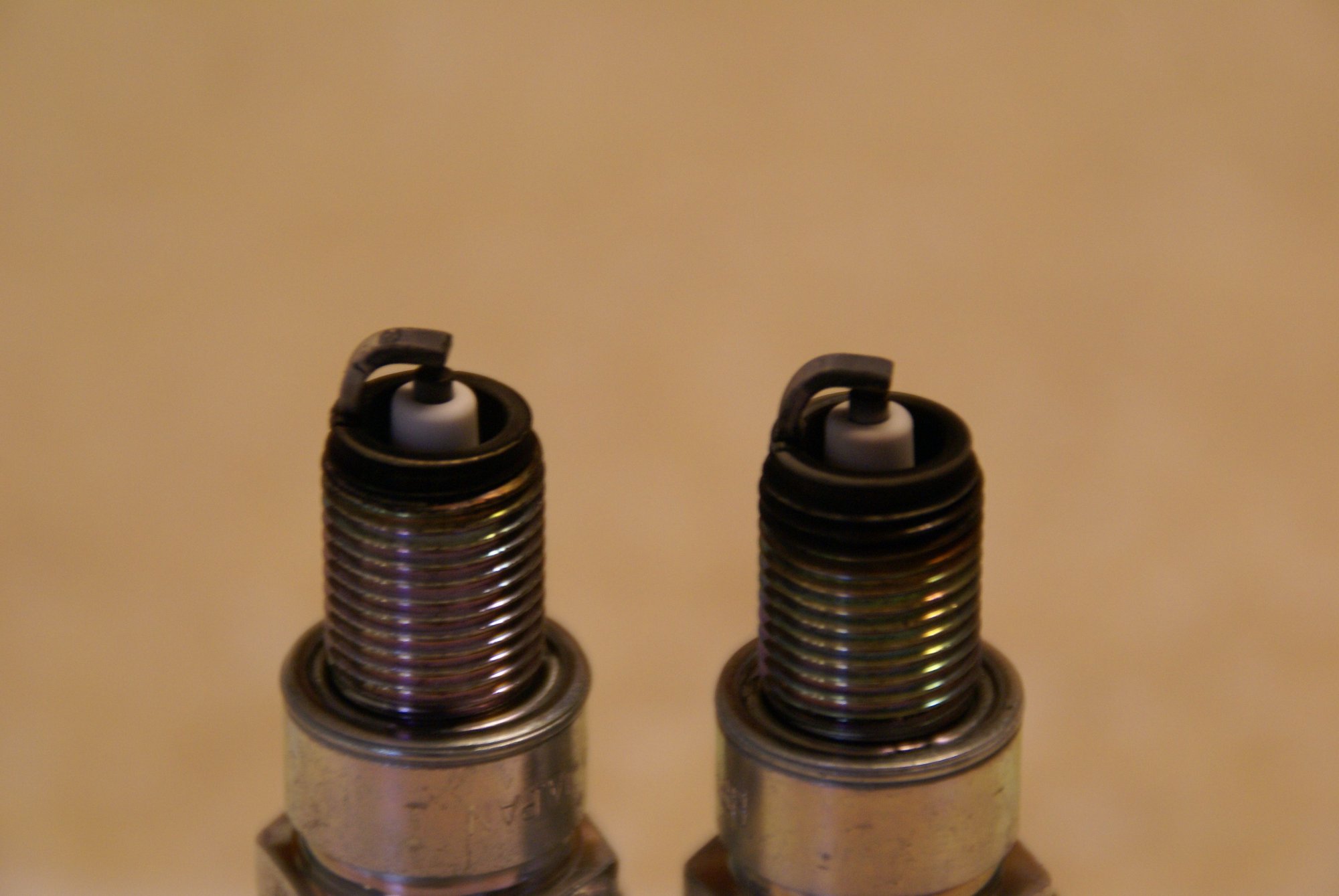

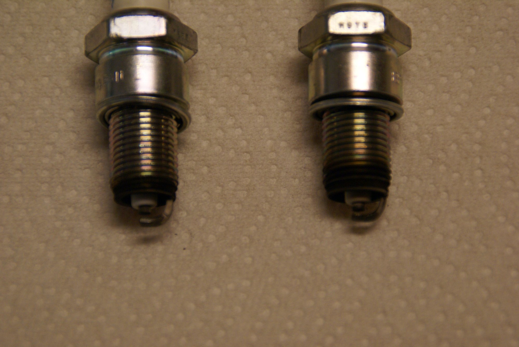

Thanks guys I'll open up the idle mixture screw some. When we rolled out of here Sunday morning it was 42 and when we got back in Sunday afternoon it was 58. Right now 32...tonight 19.
In the pics the plug on the left is from the front cylinder.

+1Uncle G, Definitely a little lean on both cylinders,

Plugs look OK as far as mixture goes, But they look like they need gapping. Should be .038 to .040.
The way I do it is .038 will pass through the gap and .040 won't or barely will.
BTW: I picked out the front plug from back without even reading your caption. Front should run on lean side and rear plug should run on rich side. It is the nature of the beast. No one knows why for sure, many theories.
I'd adjust the accelerator pump one notch and see what happens, but really sounds like the engine is running OK.
Just my $0.02
