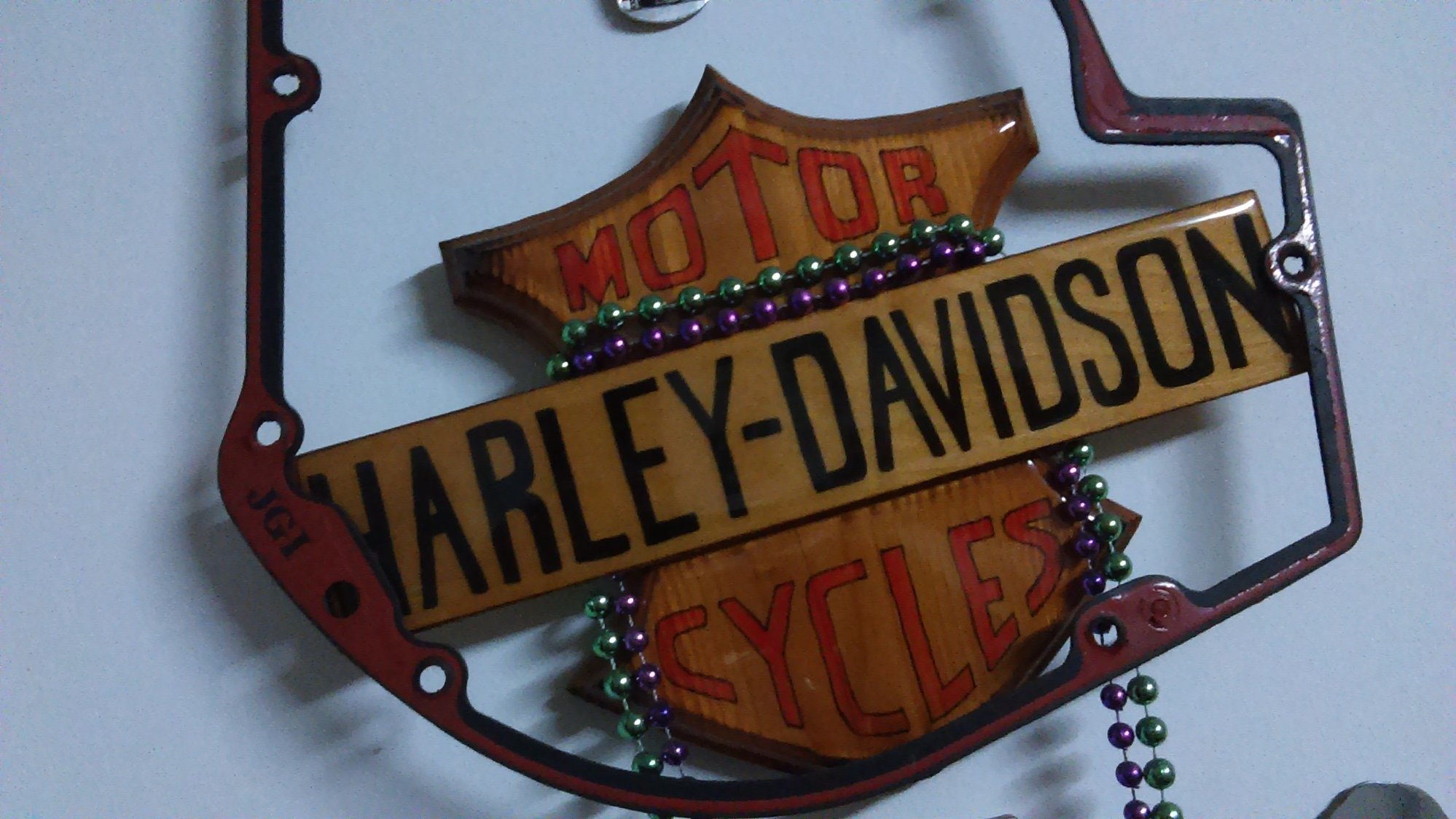

Just for the hell of it, check the length of those bolts, make sure they are not a bit too long.
These don't leak.
These don't leak.
Not the primary cover, the clutch cover. I could not figure how long bolts could make the derby cover leak!
