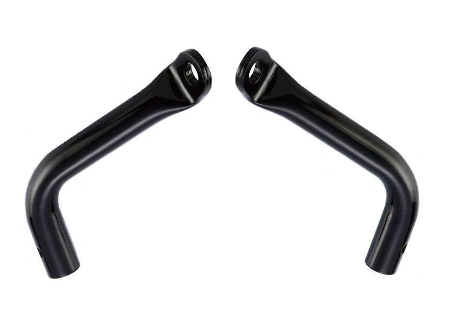

What about using the short BAGGER WERX SADDLEBAG SUPPORTS?
Make a custom search on Ebay and one will turn up. Funny but there's at least 3 left handers up there at the moment for around $20 each.
