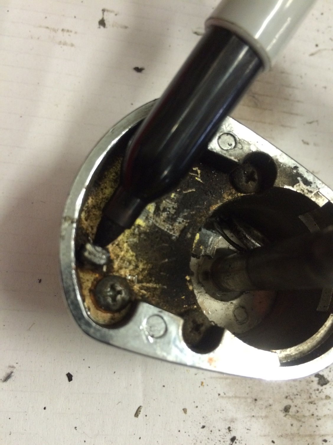

Hope this helps a little.... This is the switch out and upside down on bench. U need the key in the lock to get it out....First time is b itch

Ignition switch removal on old style fairing bikes is a PIA,
There's no release button, but a lever, I don't think you have to remove everything they did here.
How to remove key switch on 1992 HD ultra classic - YouTube
Wow, yeah, that's my ignition right there. Kind of wish I was just 'pushing the tab wrong' and take the ego shot rather than having to pull everything apart, but oh well.
Buddy even says "everyone tell you you need to push a tab, but that's not right". I hear that.
Thanks a lot, I missed that video in my searching.
Looks like you have a different style switch.
I think Schex3x nailed it.
