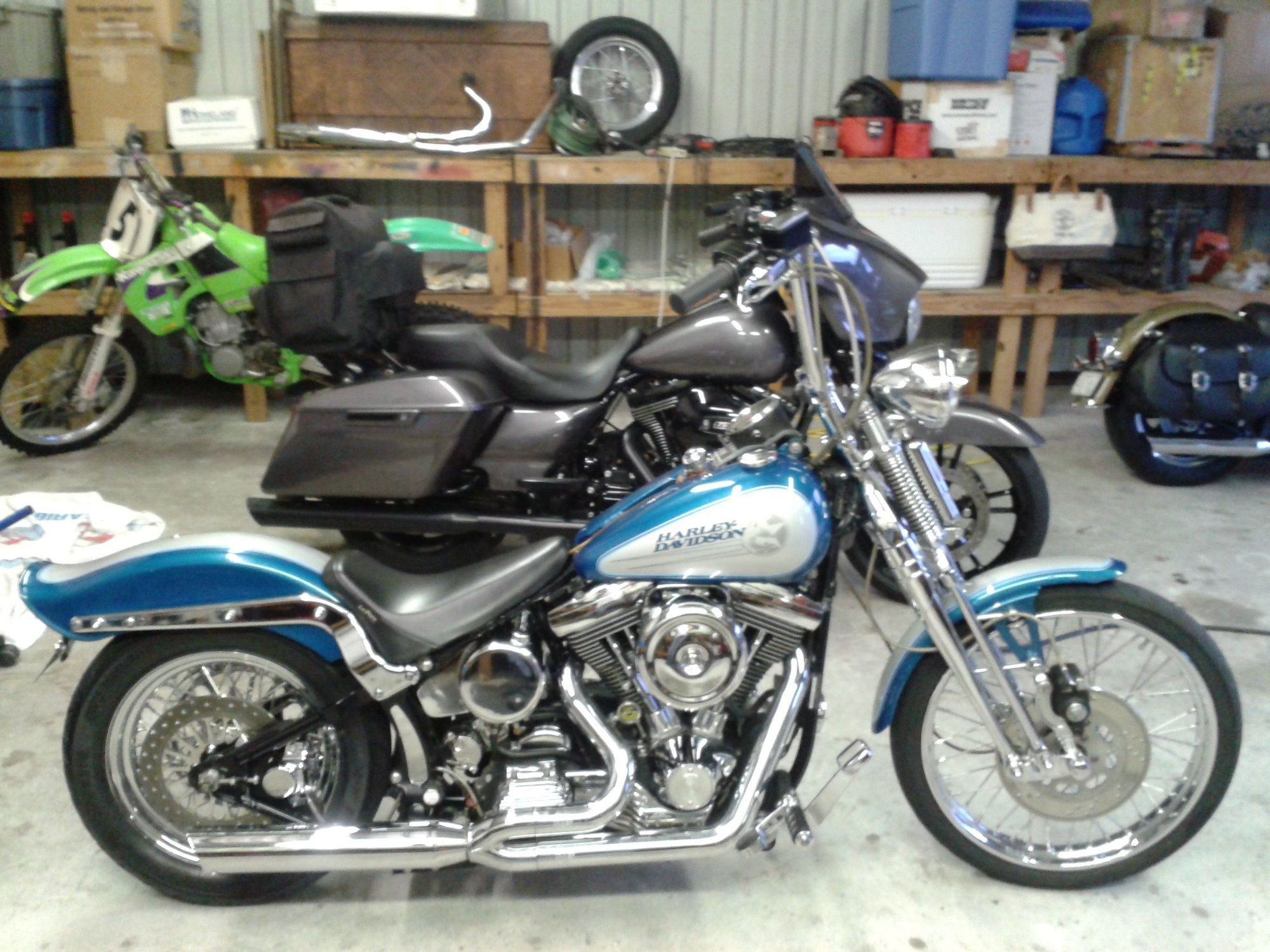

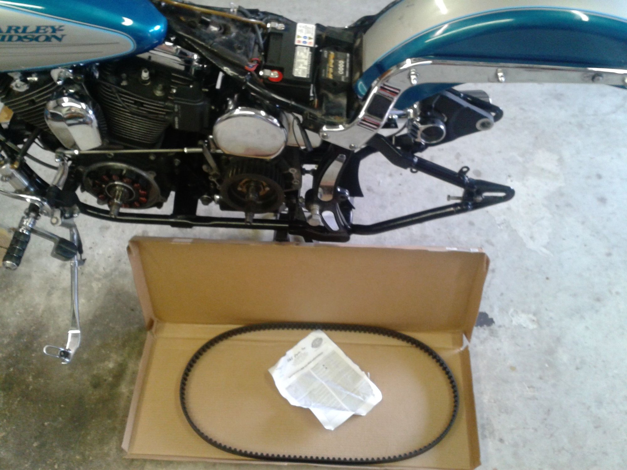

Cool 34 tooth front ...
Originally Posted by texashillcountry
Details?????
changed the rear hub to the 2000 and up sealed bearings and laced to stock wheel w/ stainless steel spokes ...replaced 1.5" belt w/ new style 1 1/8" ...and front pulley to 34 tooth(Andrews)...added 1 tooth to belt ...a 133 tooth S&S ...retained the stock 70 rear tooth but w/ aftermarket 1 1/8" pulley ...added a 3/8" spacer between the rear pulley and hub for correct spacing ..
if the details you want are of the motor ...20 over 10.25 pistons , ported 1.94 ,1.63 heads (beehive springs)...decked .050" ...45mm Mikuni , Comp Cams 5015 . .585" ...crane HIE-4 ignition ...stock coil and stock plug wires !!!
check album pictures ....

you should be able to swap the front pulley from the stock 32 to at least a 34 and not notice much of a loss in acceleration
Springs, first of all that is one nice machine and this group loves pics.
Kinda my point in the earlier babble, may not be much of a notice but it doesn't have to be any notice if components match. Comes down to the almighty dollar
