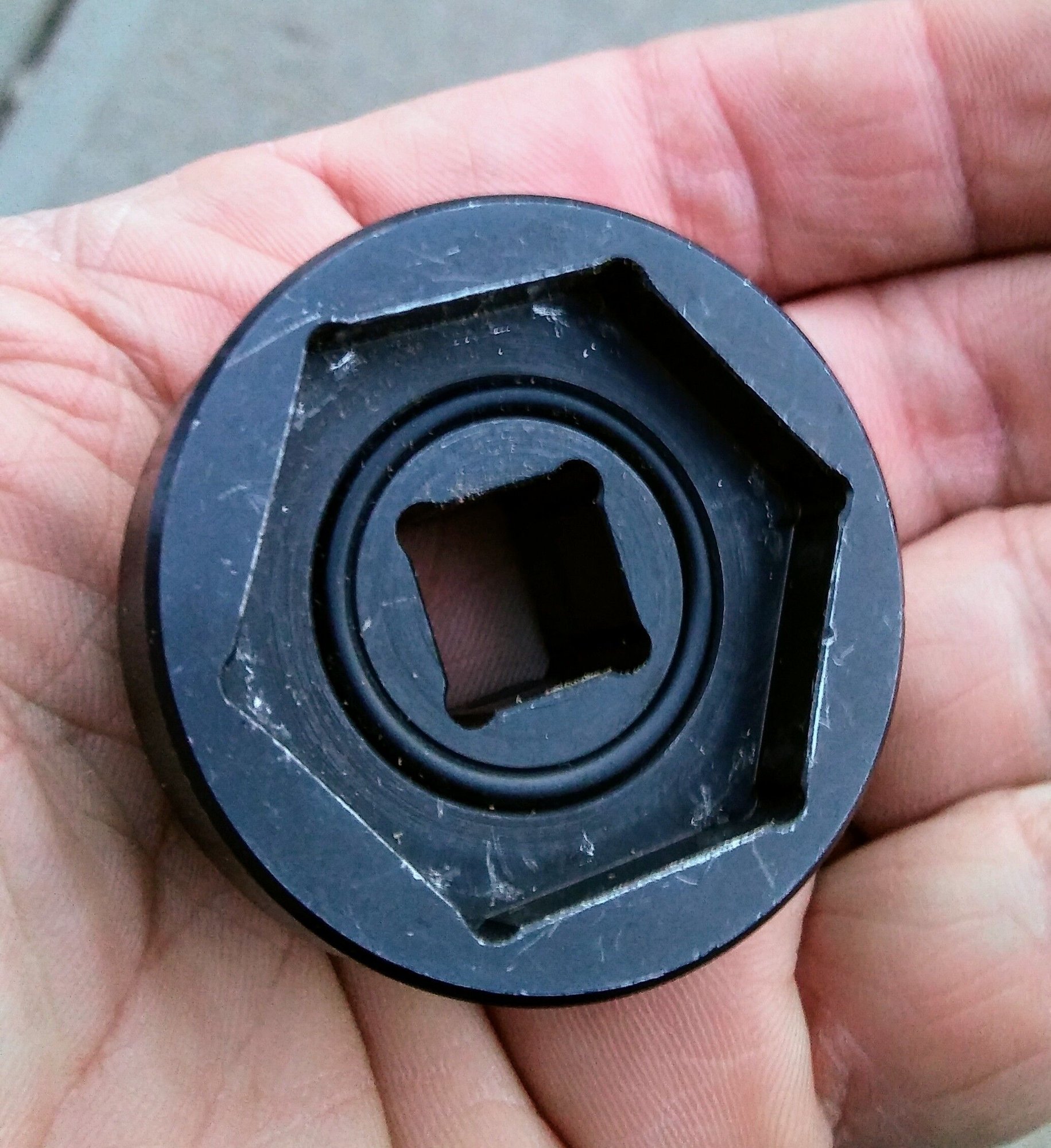

The cap takes a 1 3/8" socket. I picked this thing up a few years ago. Lovely, and the little O-ring on the inside protects the cap when you are pushing it down against the spring.
