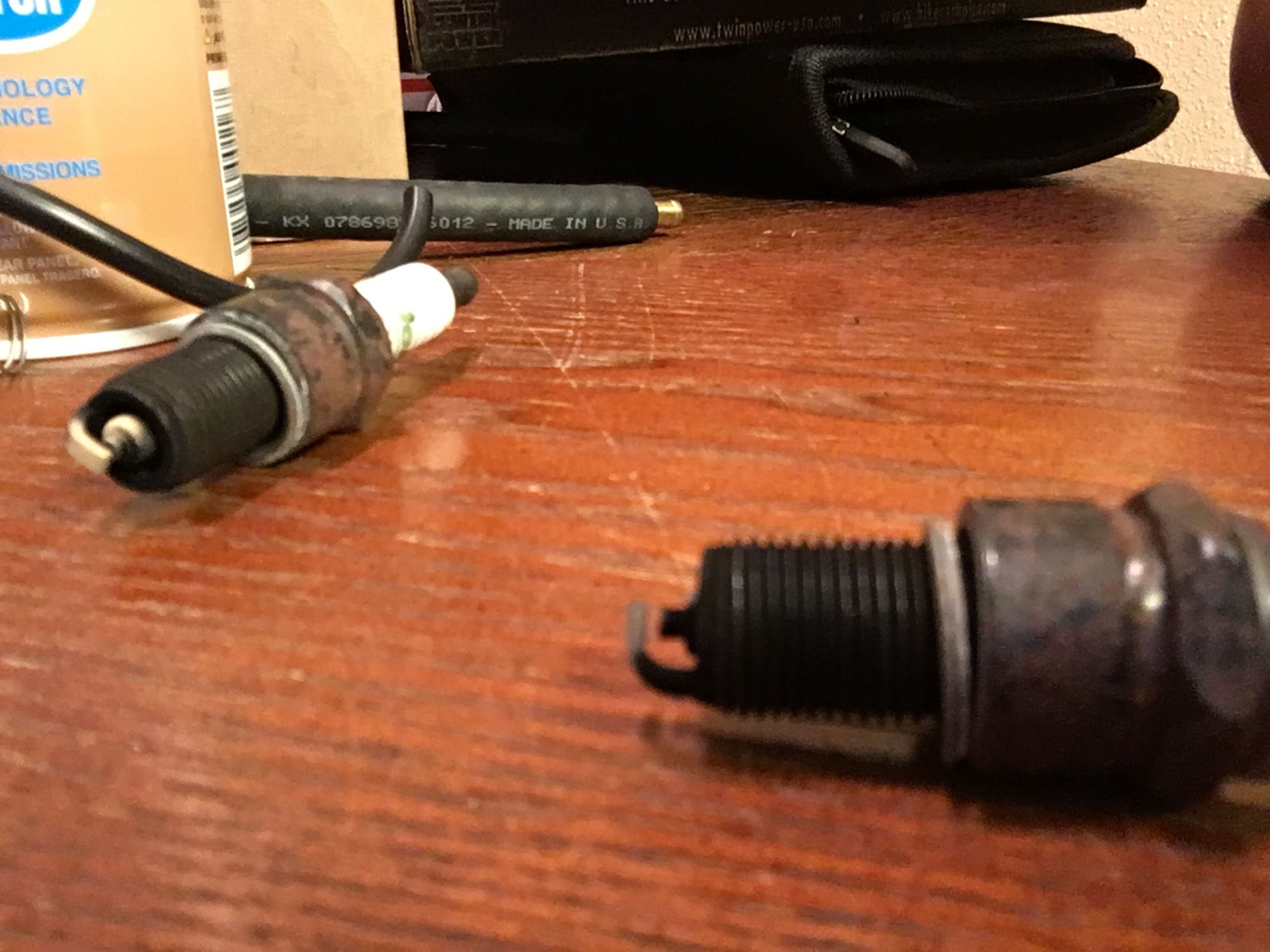

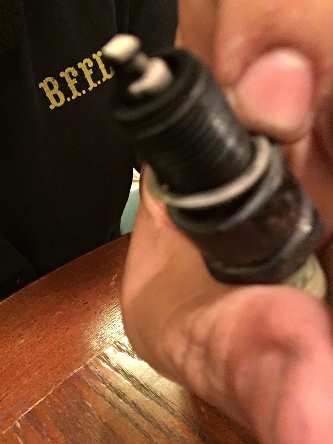

So I pulled the plugs, and they were covered in black “soot”. I was able to clean it off with my finger for the most part, but I am going to attach a a couple pictures. Keep in mind these are almost new. I changed them about a month before I started having problems. I just got a service manual today, so I had a nice long look over it. Last night it was still running better with more choke. So I think I am going to replace my spark plugs and turn the air down a bit and see how that goes. Logical, yeah?
If your plugs are sooty then I'd turn down the fuel not the air.
