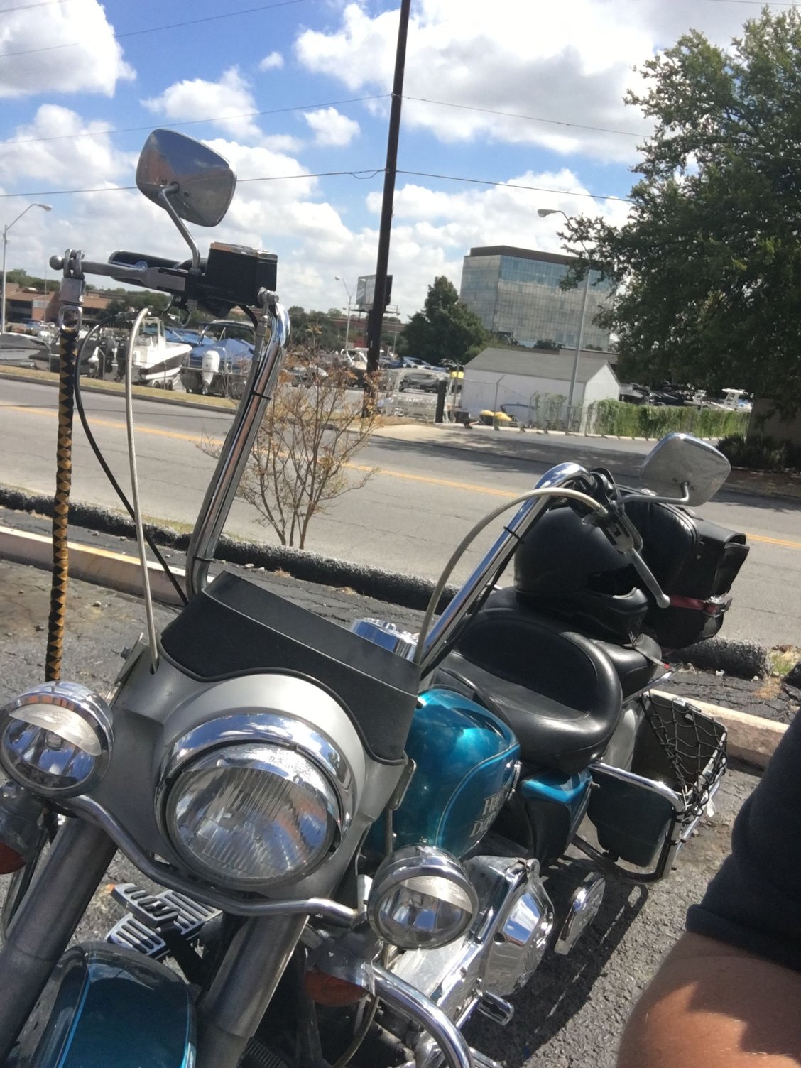

So I was on the highway today after riding about 2 hours of off and on city riding. Hit 80mph...no issues. 85...seemed a little off. 90...I thought it was gonna blow. Sputtering, popping in exhaust, just ****ed up. Lowered speed, it was fine. It also was only reaching 4K rpms MAX in 5th gear, and 4200 in 4th.
One of my brothers posed an idea. My bike had a 170 iirc main jet. Service manual calls for 185. It also has straight pipes on it. So, he suggested I put a 190/195 on it and see how it ran. Haven’t pushed it super hard yet, but it sounds way more like it did before I moved to this super hot shithole of Texas (no offense, I love it here actually lol). So just need to fine tune the idle a bit again and hit the highway. Houston bound next week!

So I was looking through some old info from when I started having issues at the beginning of the year...
Bike had screaming eagle ignition, that went out. Had it replaced with a dynatec. Tbh this was the beginning of my issues. Started losing top speed, etc. When I first got it, I could cruise at 100+. Now 85 is basically all I got. Also, RPMs cap out at 4K in 4th and 5th.
Increasing jet jet to a 190 gave me more power, but could the issue be that the VOES is disconnected, and the new ignition needs it? And is there a separate rev limiter for 4th/5th gear?
