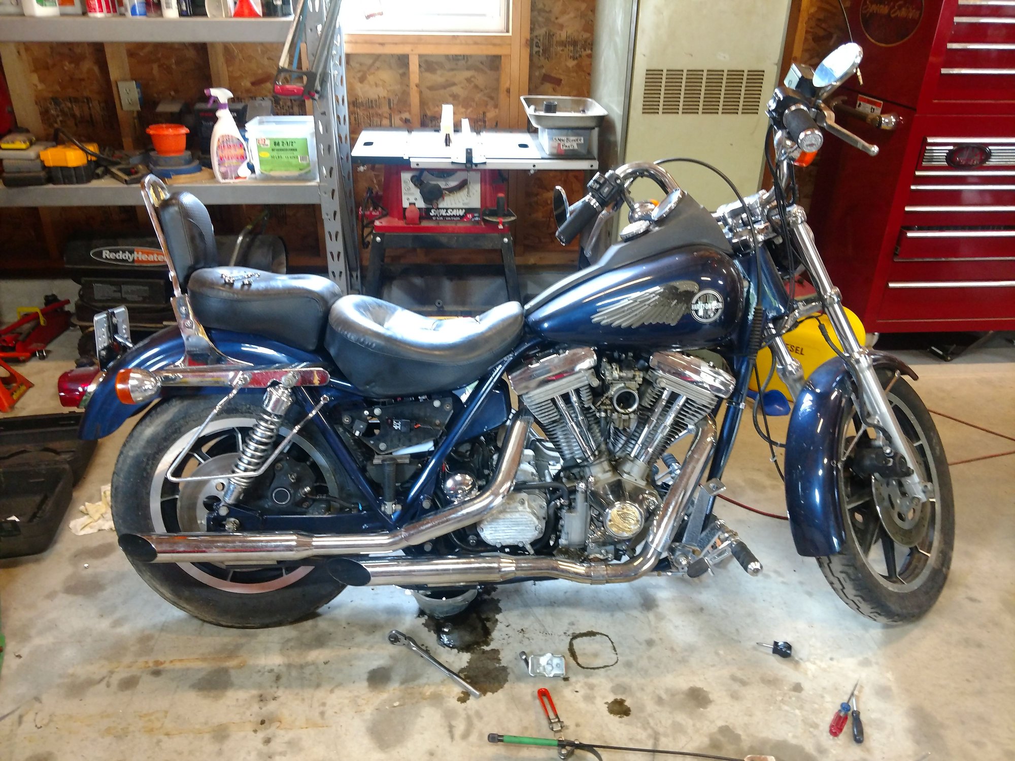

Hi everyone. I recently pick up a 88 FXR that had been sitting a couple years from a family friend. The price was right so I didn't think I could go wrong. The day I got it I put a new 330CCA battery in it, did an oil change, and drained the old gas and topped it off with some fresh stuff. The starter solenoid was weak so I replaced that as well. Now the bike will not start. I have tried everything. I pulled the starter and hooked up power direct. Spins freely without a load on it. As soon as it's back In the bike it turns the bike over super slow. Practically one revolution and that's it. I pulled the plugs or and it still turns over super dry. Anyone have any ideas or should I just throw a new starter on it and be done with it. If a new starter is the answer what and where should I get. Thanks for your help in advance.

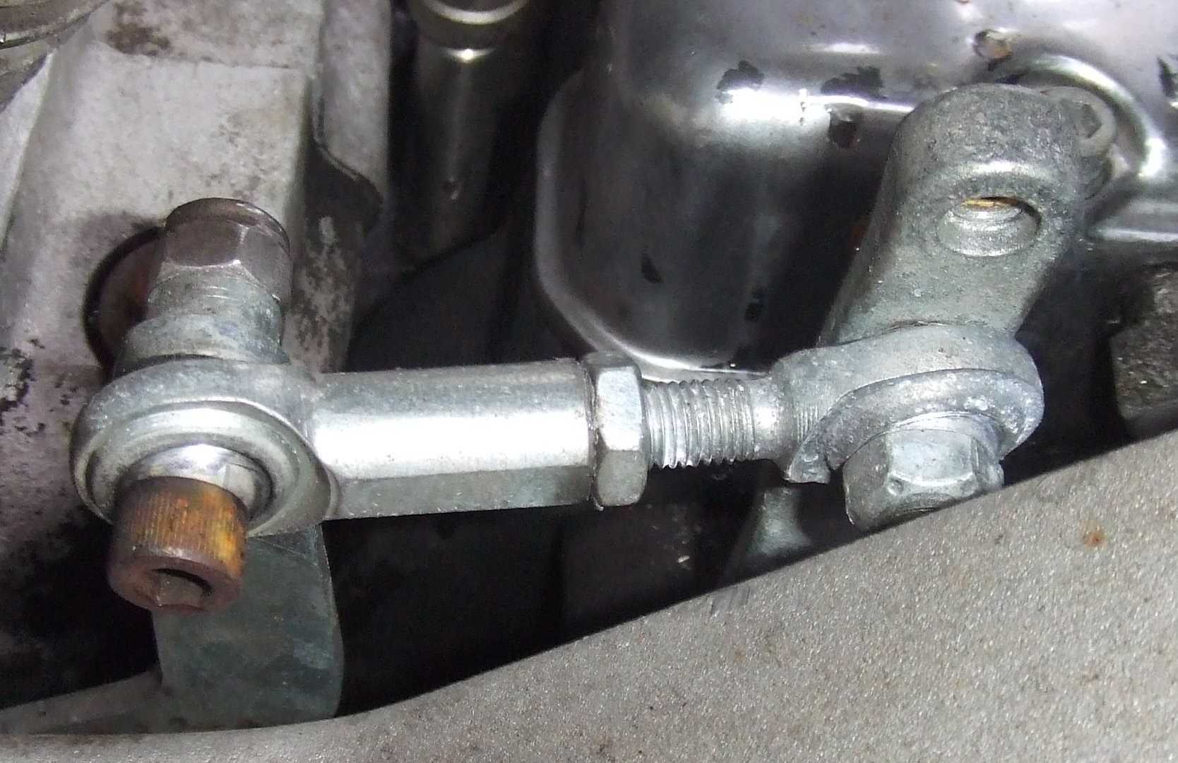

Periodic inspection and a little spray grease in there now and then will help prevent one of those ball joints from rusting out and failing just about the time you need to down shift to make a curve and get on the Interstate, 2000 mi from home about daylight on a Sunday morning after leaving the Grand Canyon.
I bet THAT was interesting!
Those cheap stock joints are the same parts used on millions of riding mower steering linkages and were obviously chosen for cost reasons. Far superior milspec aircraft Heim/rose joints are cheap via Ebay.
Pic shows male and female 5/16" fine thread x 5/16" hole size Heim joints installed on my '88. The steel Dyna transmission shifter arm replaced the soft aluminum stock arm. The pinch bolt was replaced by a Grade 8 socket head cap screw. I use red Loctite gel on the splines and pinch bolt threads.Heim joint threads get anti-seize. I drilled the steel Dyna arm to match the distance between centers of the stock arm. There is a lock nut on the transmission side. The arm on left is also a Dyna part which has a longer distance between hole centers than a stock arm. It's a common mod to increase the throw on the transmission side when using a stock length FXR transmission arm.
Had I left the transmission side arm untouched there would be no mechanical advantage because that "Dyna + Dyna" arm combo would be neutral. (When that bike comes down for paint I'll remove the extra hole/length and recontour with a flap disc. I'll also install the same all-metal lock nut I used on the tranny arm on the forward arm for improved appearance) I've run this setup for years. It's cheaper then the repop versions of the stock assembly.
