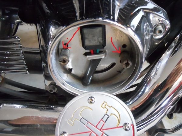

Originally Posted by brunom
Hi,
About the evo timing cover, i can see 2 kinds available on ebay, this (horizontal):
and this (vertical):
so which one do you think will fit? behind the rivets is supposed to be screws?
also, it is on the right side cover, not the left like i wrote
thanks
(orry i cant seem to be able to resize them pictures)
The top cover with horizontal holes is more traditional for big twins. Sportsters use the vertical holes.
After removing the riveted cover you will find that there are threaded holes left and right holding your ignition plate on. You will need to install the stand-off's pictured (which you can get for a few bucks at Harley) to convert to using covers with horizontal holes. That is unless you just want to rivet your original cover back on.
