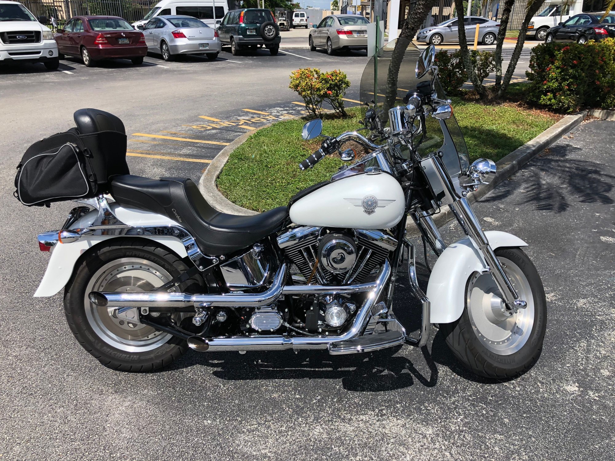

Went to Daytona this year (2019) to have Baker install a New OD6 Trans.
On the way home in the middle of the Night Speedo stopped working. You can turn off the Ignition on the Dash and the SpeedO's Light turns off, Turn it on, it lights up, goes through it's little routine but that's it. Also there's No Codes logged in the SpeedO. The Needle doesn't move at all and no new Miles are recorded. Clearing the Trip works but No New Miles are logged on the Trip meter.
So I checked all the Wires for Continuity and they were fine.
Then I checked the Voltage Reg and Stator and they are fine
I decided to replaced the 20 year old VSS with a New one, That didn't Fix it,
Then I replaced the 20 year old Turn Signal Canceler and that didn't fix it.
So as a last resort I bought a New SpeedO and that didn't Fix it.
I even Dielectric all Connections on the Bike and that didn't Fix it.
The Bike runs great with out the SpeedO but we all know that's not good.
I'm completely Lost on this one.
Any Ideas?

Thanks Everyone for your Help, You Jogged my mind and made me dig deeper.
I figured it out. My 1991 Harley FXLR's Baker OD6 was installed by me and it doesn't have the New SpeedO Sensor. So I grabbed the install Instructions Baker Included,
The Baker Mechanic didn't move the SpeedO Sensor to the New Position on the OD6 Door. It took me 20 minutes to fix. Then I had to use the Baker 95E-56B SpeedO Tool to recalibrate the Speedometers Speed.
It like to have drove me Crazy.
Again.....Thanks everyone I would've never thought of it had it not been for you Guys....!!!
This Fatboy Fly's Now. At 89 MPH the Tach say's 2,900 RPMS. the Sweet Spot is 3,200 RPM's.
