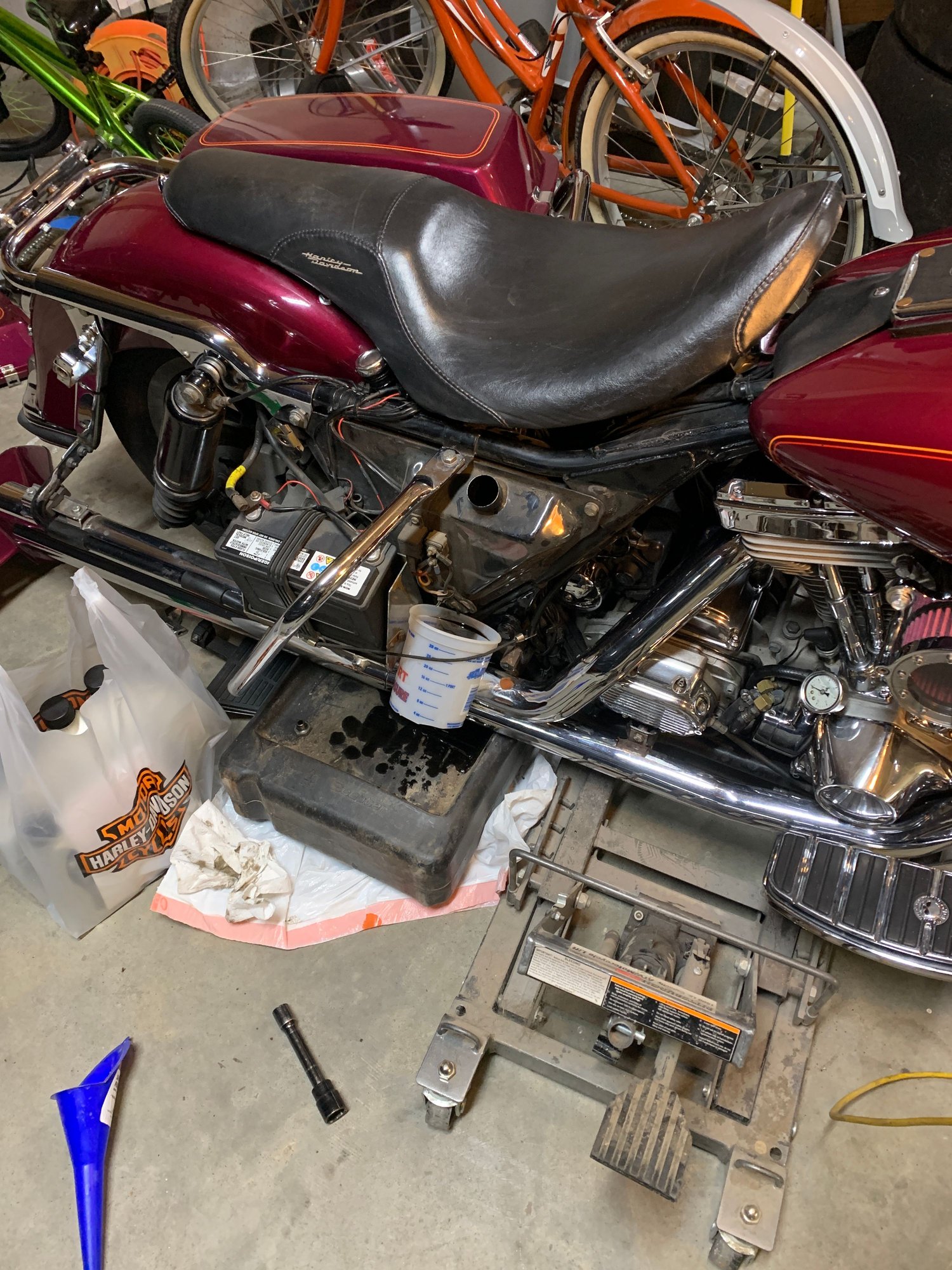

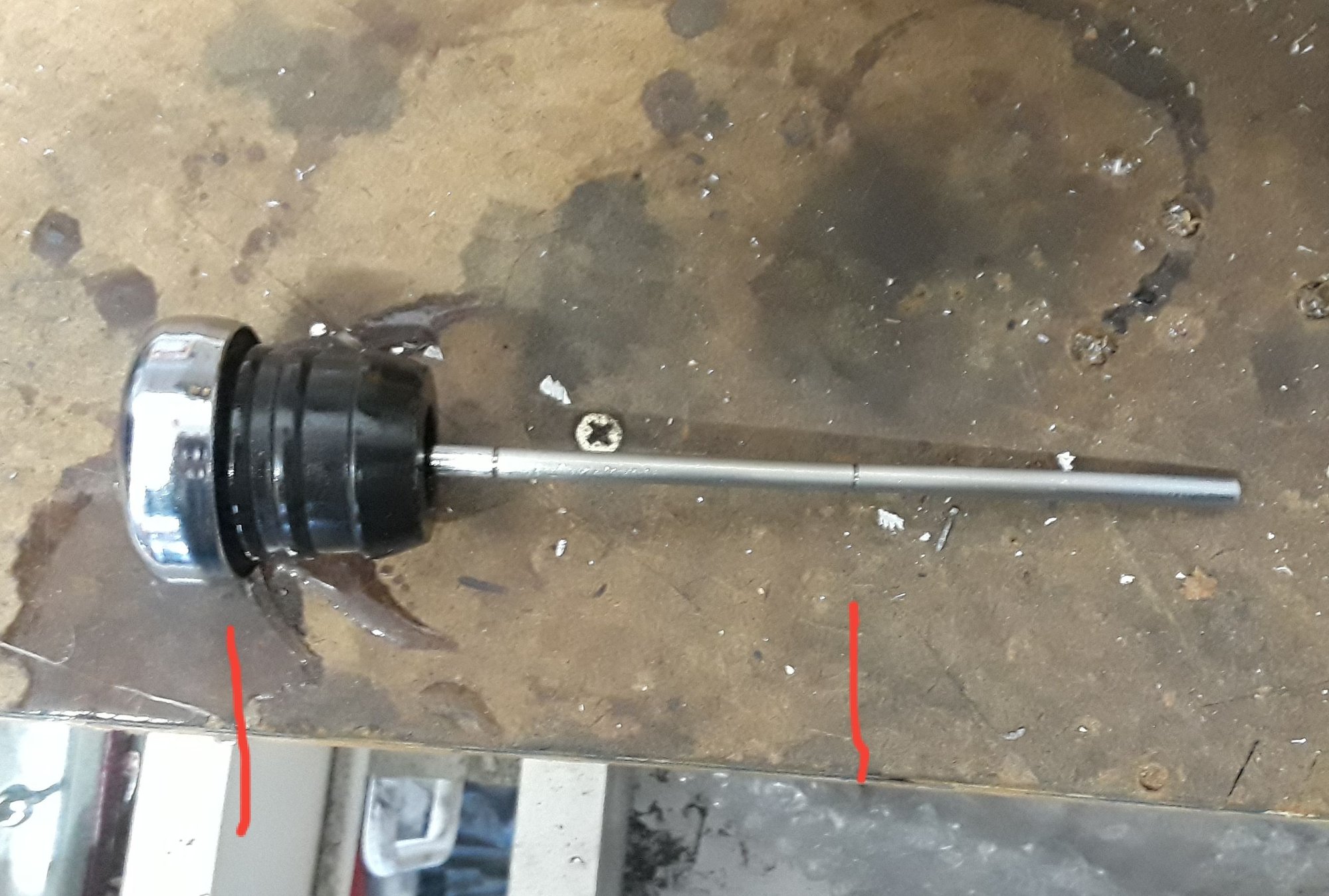

I just picked up a 91 flhs and it has an aftermarket dipstick thermometer which has no level marks. Could anyone possibly measure their factory stick and see where the marks are? Would be much appreciated!

Ive got a 92. Looks like youve drained the oil out of the tank- i put in 2 quarts and run it. There may be up to a quart of oil still in the crankcase depending on how long it sat. Put in the 2 quarts- run it (without the dipstick in) watch how much oil returns to the tank. When its warmed up- check the oil level-and add if needed. My 92 takes 3 quarts- any more and she'll start spitting it out the breathers.

I just measured the stick on my '90. I got 3 5/8" from the bottom side of the cap to the center mark.

Thanks brother, I assume the proper level is between the 2? Appreciate your help

I keep mine just over the middle mark...maybe 1/2" or so (measured hot).

The one on Kristy’s 08 x bones looks like Omaha’s and, I also keep it just over the line in the middle. It is not factory. And has an anolog temp gage

The bottom mark is: "OMG, time to top up" - the top mark is: "that's quite enough"!
There is no need to try to find the correct dip-stick, simply mark a suitable alternative one at those two points. A punch, small nick with a handfile, or disc wheel should do.
