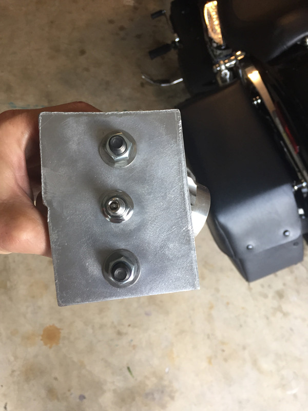

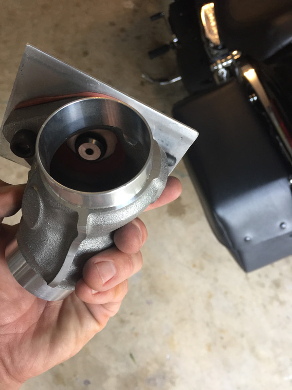

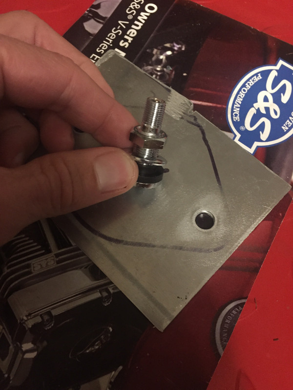

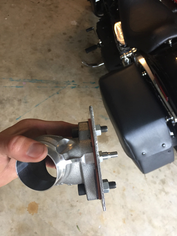

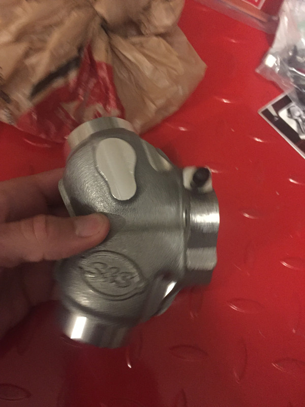

A couple pieces to the puzzle arrived. Got my new used manifold. The schrader valves showed up so I can finish making the pressure tester, and picked up some make a gasket to cut for the pressure tester against the manifold. Still waiting on my parts order from S&S. Should be here mid week but I have to work all weekend.

Tool is done. Will tackle this on Monday/Tuesday

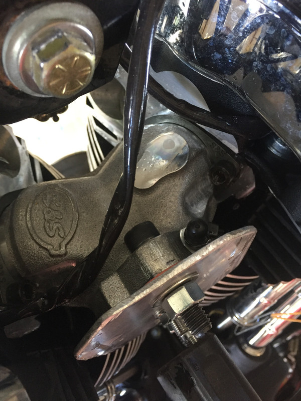

New intake manifold on and spaced. I didn't see any bubbles forming
