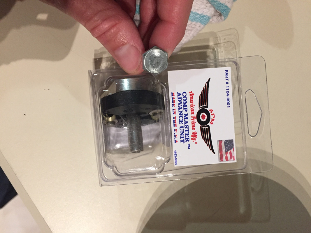

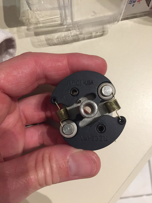

New advance at the house. Going to install tonight. A really nice one if any of you guys need a replacement in the future. American prime manufacturing.
