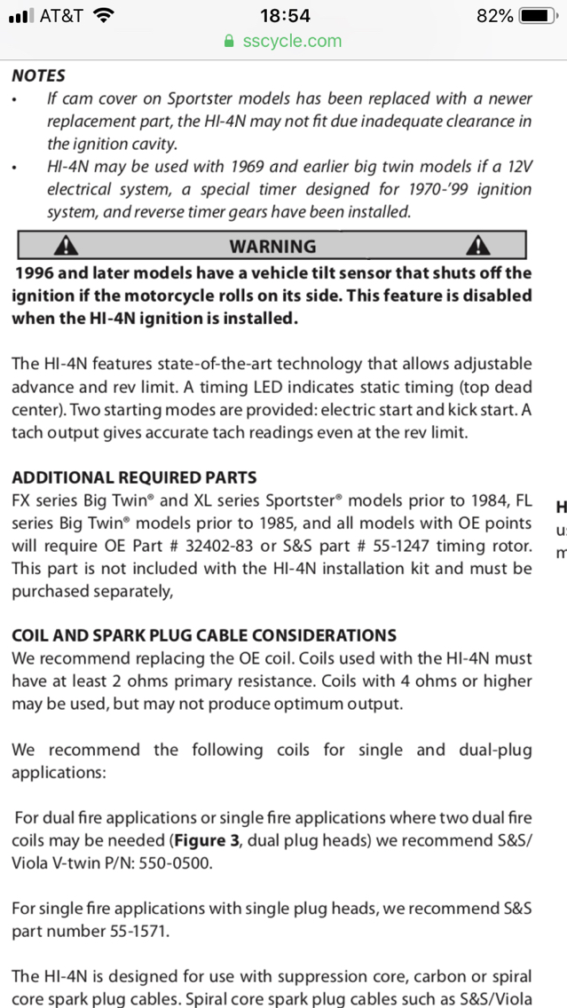

Just out of curiosity what part number does S&S call for in the 111?
I misspoke. It's the one that the Hi4n ignition instructions call for.
Old Oct 20, 2019 | 06:39 PM
  #89
texashillcountry's Avatar
texashillcountry
Dirt don't hurt
Posts: 21,065
Likes: 4,561
From: Haslet Texas
Attachment 600092
Interesting.
Not sure what that has to do with a 111 but it's interesting.
