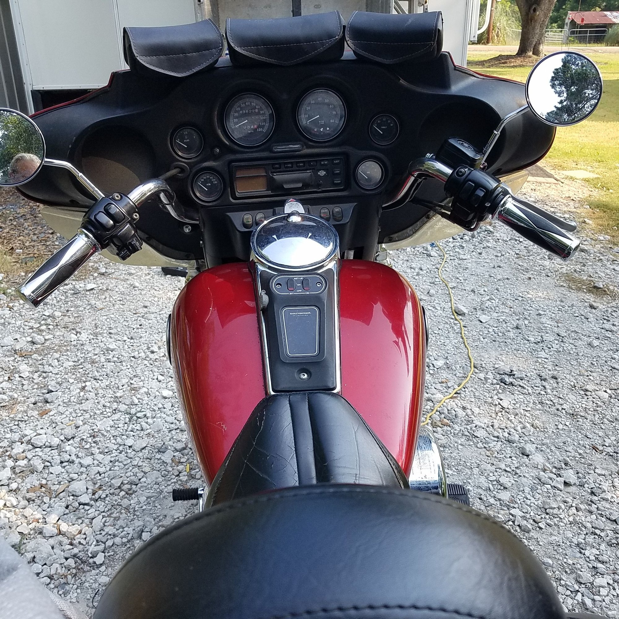

The more I look at handlebars, the more confused I get. Most won't fit my 98 ultra fairing right off the bat.
Don't know if mine are stock or not, 32" end to end of grips and killing my back on the road, need more like 20" and pointed more towards me. Always used 8- bend on old bikes and they were ok. Existing are 1" bars.
Any tips from those who have gone thru this?
Thanks. Ken

The problem is the distance in the mounting "plane" ... extra wide on those FLHT's before any rise.. measure the Flat [horizontal] part.. and go see yer Indy for a Proper bar..
We always sit on the Bike...level .. feet on boards [or pegs] .. eyes closed.. or better yet blindfolded, .. hold hands where comfortable, and have a Partner do some measuring... especially width and pullBack....

Can you roll your bars up any? From the picture they look like they're rolled downward. Rolling them up will bring your grips up out of the bike.

I can move the bars , Crashbone, but my problem is the grip to grip width... too much for my old messed up shoulder and middle back. 32" is just too much. So I will modify for 24 or so and at the same time point the grip ends more in my direction .
