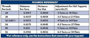

My understanding is 2.5 turns on PRs that are 24 TPI gets you to .104= (.0416 x 2.5 turns). For standard lifters of .200 travel, this would get them about middle pre-load setting. I was going to try for 3.5 turns, which would set me at .1456 for the Woods 6 cam, but the lifter didn't bleed down. Then I backed it off incrementally to 3, 2.5, 2, 1.5, 1 turn and then zero lash.
Last night, I put her back to zero lash (because I couldn't finger turn PR at any other setting) and started the bike to run it hoping to maybe clear debris that could cause the lifter not to bleed down. May or may not work. I'll go back in and try to reset it tonight. These aren't the EZ type adjustable PRs that you can take out without removing the rocker cover box. I would have pulled the lifter already.
Just looking for more ideas. Thanks.
Chart attached for the 24 TPI, 3.5 turns would be close to what you want to set lifters for a Wood cam, 2 turns is going to be shy of OEM .100 setting, is the lifter piston seized in the bore?
