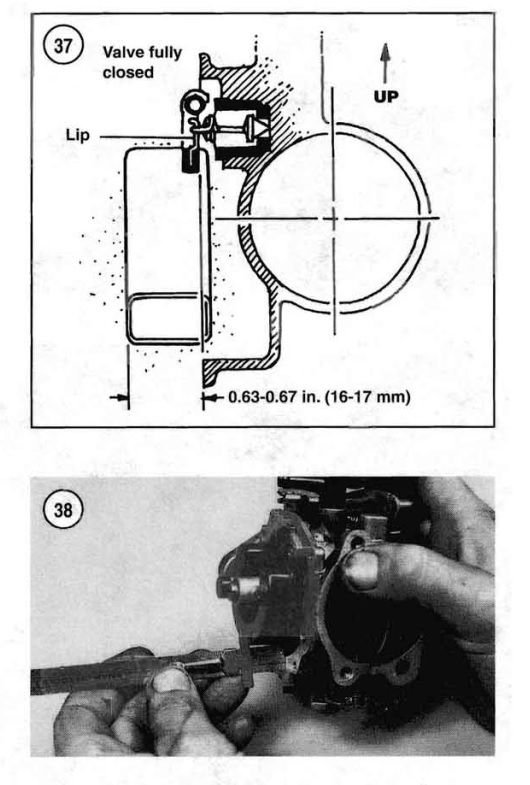

1-overflow tube
2-yes
3- no (if I do I get no overflow, the valve of the tank is working)
4- yes, the needle is good
My problem is the procedure to adjust.
From the 2 videos, I show which one is correct?
1 - (13:52)
2 - (5:45)
3- Manual
This is the manual

Basically, you want the float at level with the surface of the bottom of the body, just as the valve closes. Video 2 is for the later CV carb, however if your needle valve is the spring loaded type, I'd use video 2. That is, the carb at a 15 degree angle when checking the float.
You can do an assembled float level check on some CV models (that have a drain screw) but not on the butterfly model.
SOLID (original type) on most butterfly carbs
SPRING type used on most current carbs and they are interchangeable.
Some guys use a cotton swab (Q-tip) with metal polishing paste to clean and polish the needle valve seat. They are brass and don't corrode but can get rough over time from deposits so they don't seal well. Tiny amount on the swab and using a drill or twisting with you fingers, work it till it's mirror shiny.
