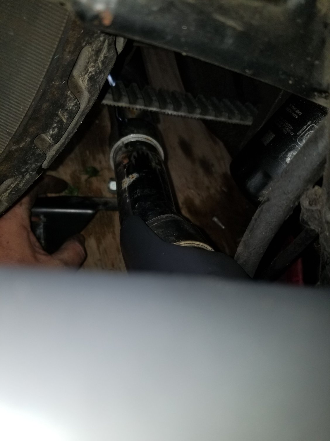

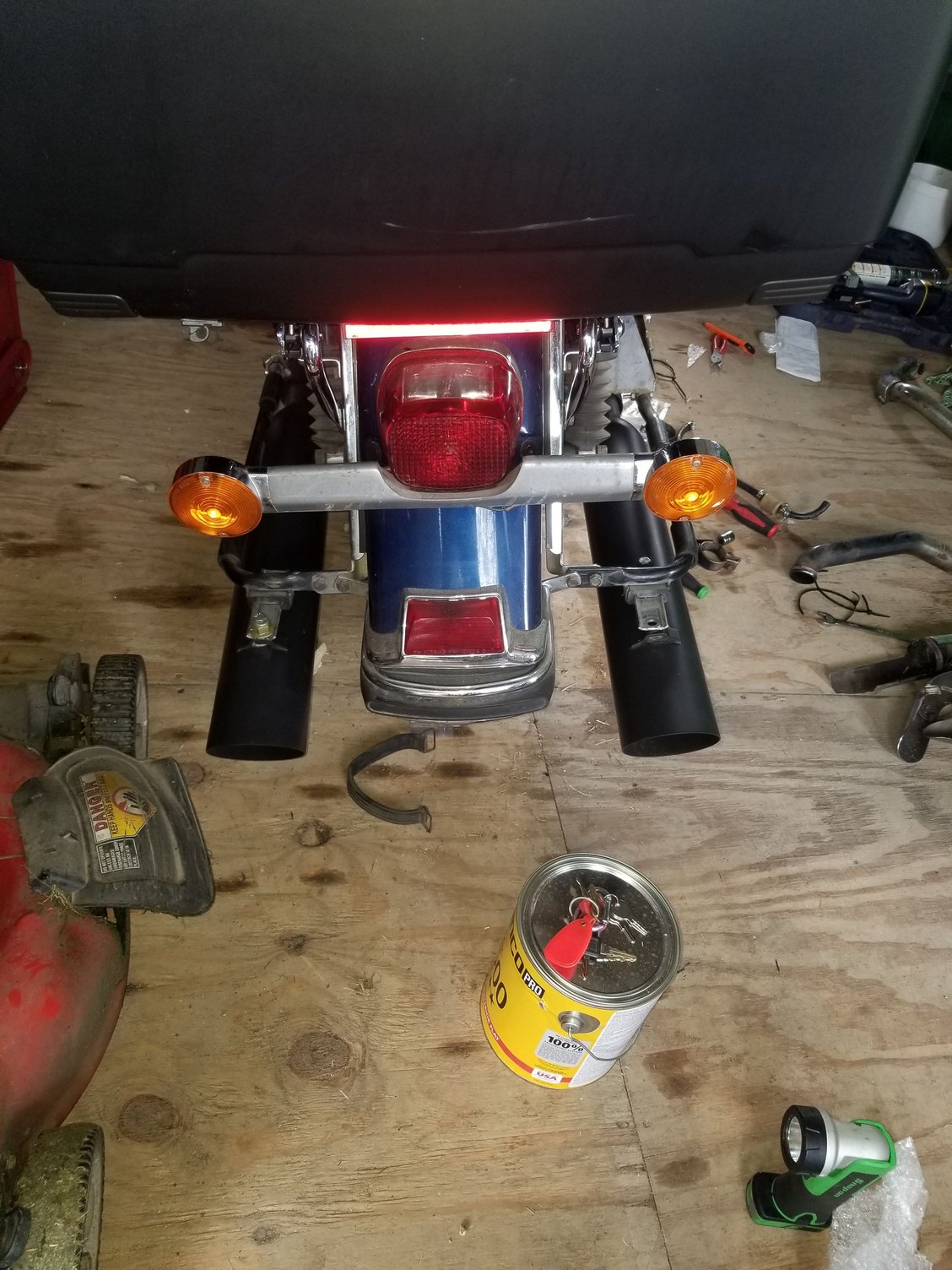

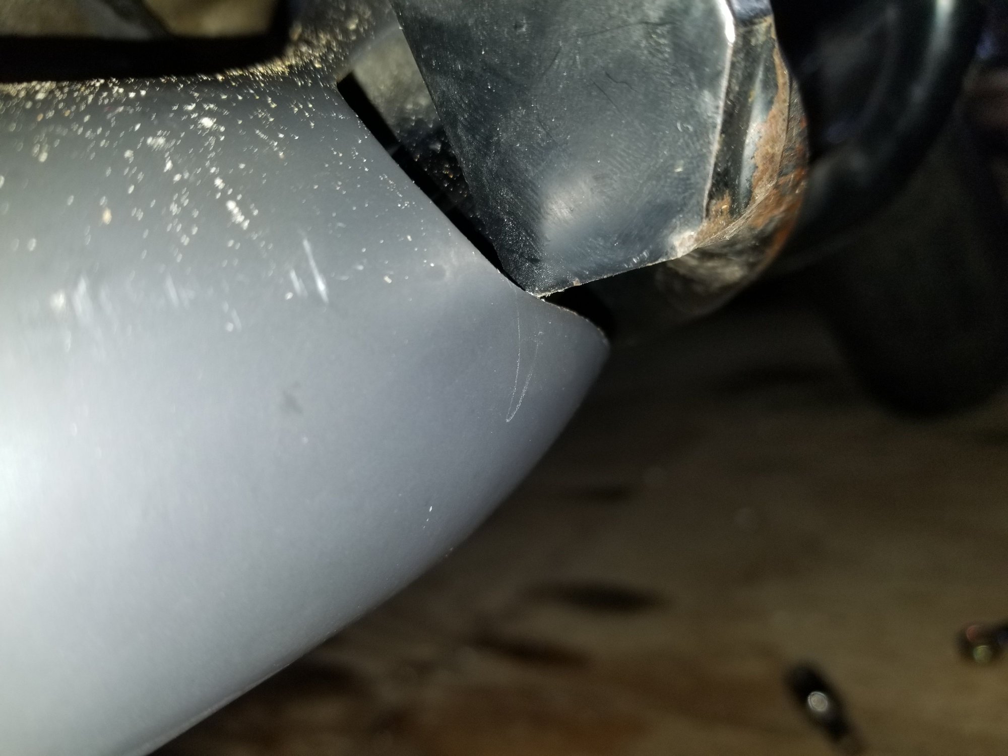

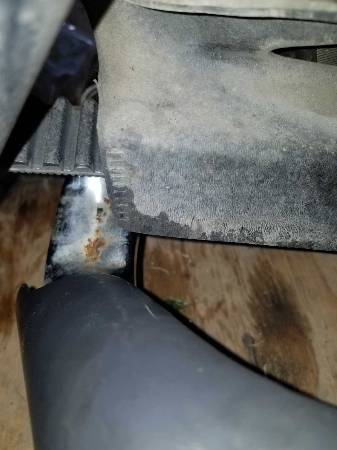

Well I bought some. I recieved the slip ons last monday and finally recieved the head pipes today. Only a few small issues to resolve. The brake pedal arm hits the heat shield, that's an easy fix. The only hard part is going to be fabbing a mount for the middle of the pipes. Theres going to be one bolt in the bottom because the bolt hits the frame. The crossover pipe gives enough room to get the oil filter out. The belt dent is about a belt width off. But there is clearance for the belt and once there is a rider on it should give me more clearence. I might try to flatten it where the belt goes just to make sure but that's still up in the air. My bike is an 87 flhs converted to a flht
