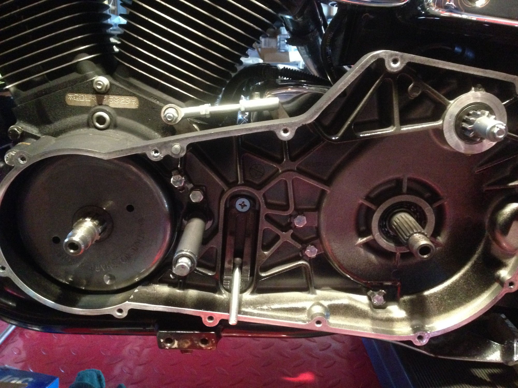

Thanks for the tips! I don't recall seeing in the manual the part about loosening the engine and transmission. I'll have to review it more closely. Here's where I left it last night.

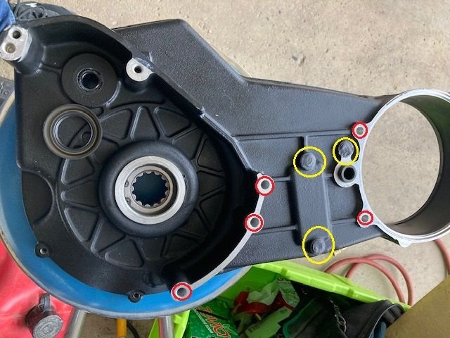

Use the hylomar with a new O-ring (the large one) that surrounds the stator housing. Use it on both sides, a light coat on the block side, and a light coat on the inner primary side.
Also, the manual is kind of weak on how to seal up the primary, in the pic below, you run a bead of silicone sealer around the holes that are marked red. You also check/replace the sealant (on the back of the inner primary) on any bolts that are threaded and pass thru the inner primary like the chain adjuster bolts and the one bolt that holds the plastic shifter tube (yellow).
Putting the inner primary on can be a little tricky, so dry fit it a time or two without the large O-ring, no sealant, and no inner primary bearing seal to make sure it all lines up and nothing interferes. Don't forget to put the shifter arm back in the plastic tube before putting the inner back on for the final time.
