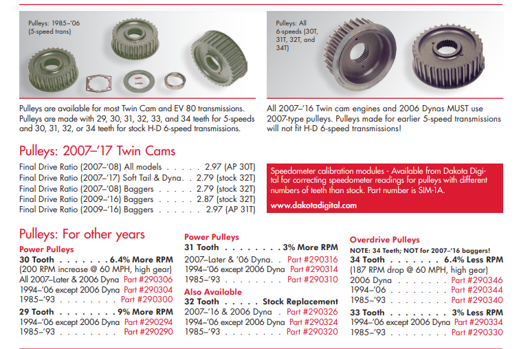

I think these guys have it covered, I cant think of anything to add to the list, you did mention '93+ style pulley spacer, so your upgrading your sprocket? I'm just asking because the newer spacer will not space your original style sprocket far enough away from the transmission

The upgraded parts are mid `94 and up (not `93).
Just tell the parts guy it is a `95 or later when you get oem parts for the transmission sprocket.
Sprocket (pulley) 40250-94C
Spacer 33344-94
Sprocket Retaining Nut 35211-91B
Lock plate 40251-92A
Screw (2) 3594
Oil Seal 12067B
Quad Seal 11165
Oil Seal, main drive gear 12035B

Andrews pulleys for '85 - '93 come as a conversion kit with the spacer, lock plate, screws and seal,
32t - 290320, 33t - 290330, 34t - 290340
https://www.denniskirk.com/andrews/t...d/80649832.sku
The OP needs a sprocket and hardware for a mid `94 or later.
32T 290324 (stock size).
33T 290334
34T 290344
