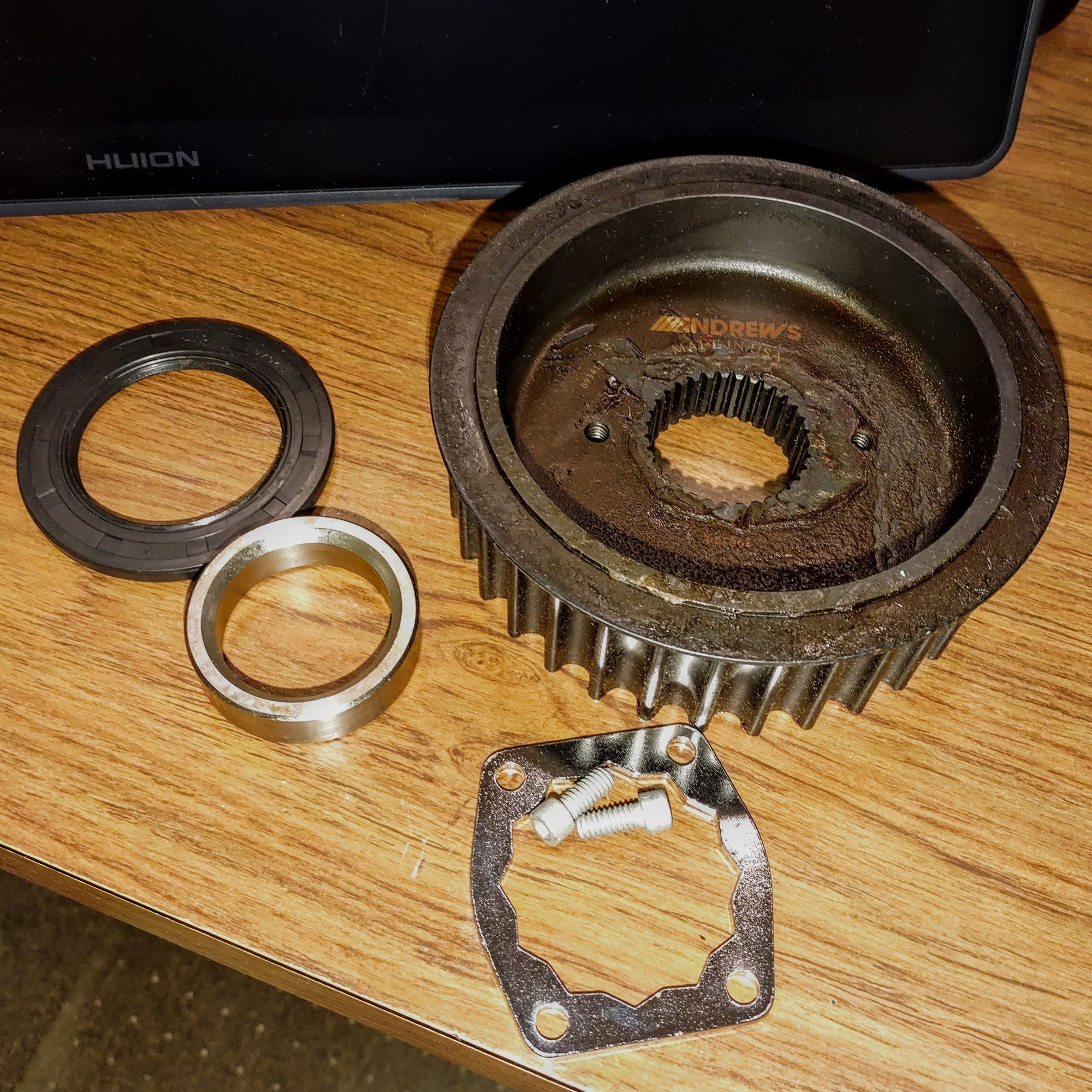

Just about in business now. This getup just arrived:
That's everything that came in the box from Andrews, part # 290340.
The only thing missing now are the new bushings for the shifter shaft in inner primary. Mine were getting pretty sloppy, so I'm going to go ahead and replace them while it's all apart. Unfortunately, none of the local dealers had any, so they're on order. Supposed to be in sometime in a week or so.
Meanwhile, I still need to get the starter out and the right side exhaust removed, so may as well get that done while I'm waiting for parts. Also looks like I need to get to work with some parts cleaner on that pulley. They weren't stingy with the anti-rust on there.

You will be happy with the andrews parts. When you slip that pulley on to the main shaft gear it will become one solid unit, even before you torque the nut.
