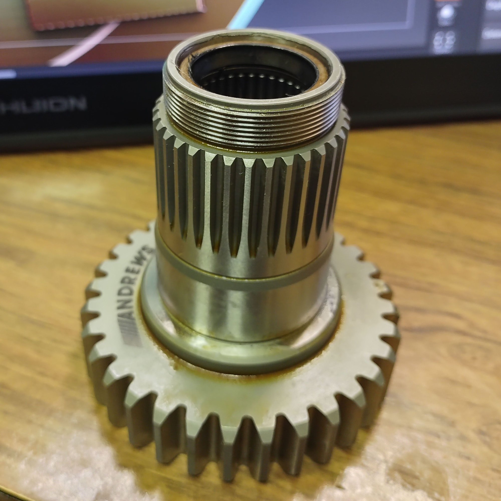

Well, that was quick. The main gear showed up already.
If there was any doubt about getting away with keeping the old one, that doubt went away when I saw those beautiful, brand new splines on this Andrews.
Looks nice.
