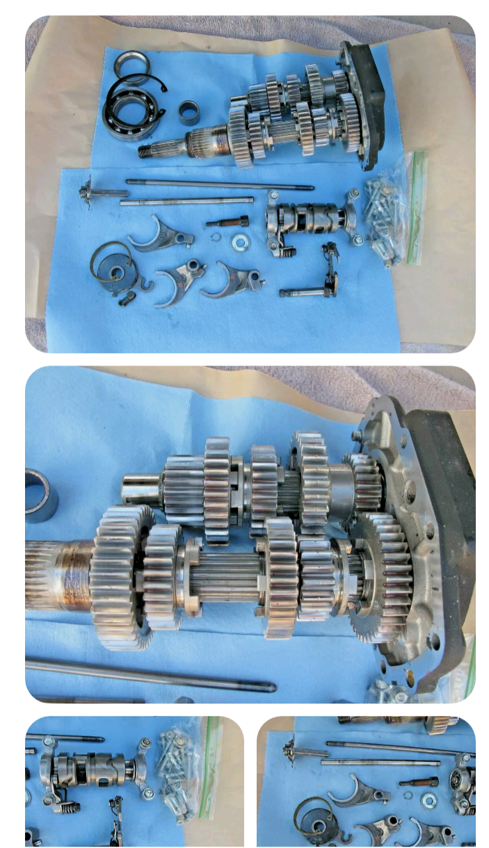

This is tempting. Just under 15k mi for about $250. Supposedly only pulled to upgrade to a 6 speed. Can someone explain to me why they call it the Trap Door?

That's a gear set with the trap door. The trap door is only the plate for the bearings for the counter shaft and main shaft...

If you use that gearset you should also use the shift pawl and shift drum that are with it, they are the late model hardware.
You will have to either replace the shifter shaft bushing in the transmission case or use a spacer.
Also, when you reassemble, if you are still running the original transmission sprocket you should replace it with the upgraded sprocket, spacer, and lock setup (these parts came out in mid `95).
The parts may still be available as a kit, HD part number 40210-85D.
