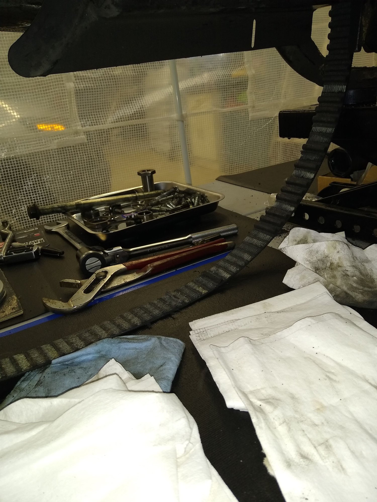

Honestly I never really fully understood what your situation is.. For some reason I was a little confused... if you're pully and gear set and 5th gear is fine there's no reason why you shouldn't be transferring power to the rear wheel unless that is you blew your clutch basket..
Now that you're into a little bit what exactly is happening.. what exactly what's going on...?
See belt pics and missing teeth cogs. Was grinding like gears were not engaged fully. But I could shift up and down all the way thru. Clutch pull and release seemed to act normally. Did not feel like it was slipping. I know what that feels and smells like. It was engaging so harsh when it did catch it would rip off belt teeth. Fully expected sprocket and main shaft damage.

Ok, I understand your situation a little better now.. So you have a 91 with 50K on the clock.. Sounds to me that the clutch is a little out of adjustment and the belt is just too old... Adjust the clutch by the Book and replace the belt and you just might be ok.. I don't think you have greater issues... It sounds like a combination of the clutch out of adjustment and a 30+ year old belt are your only issues...

Could be possible. Hope it to be that simple. Hate to miss something, but I don't see how much deeper I can dig. Almost quite certain I went thru the clutch adj procedure shortly after I purchased bike. I will go back and review my threads and see if I asked for advice here on that. Definitely used the FSM to perform adj.
Curious why the issue would be so sudden tho. No warning or symptoms. I can say I did a bar upgrade a few years ago which included a longer clutch cable. All that involved was a cable adj. Not sure how that would be related.
