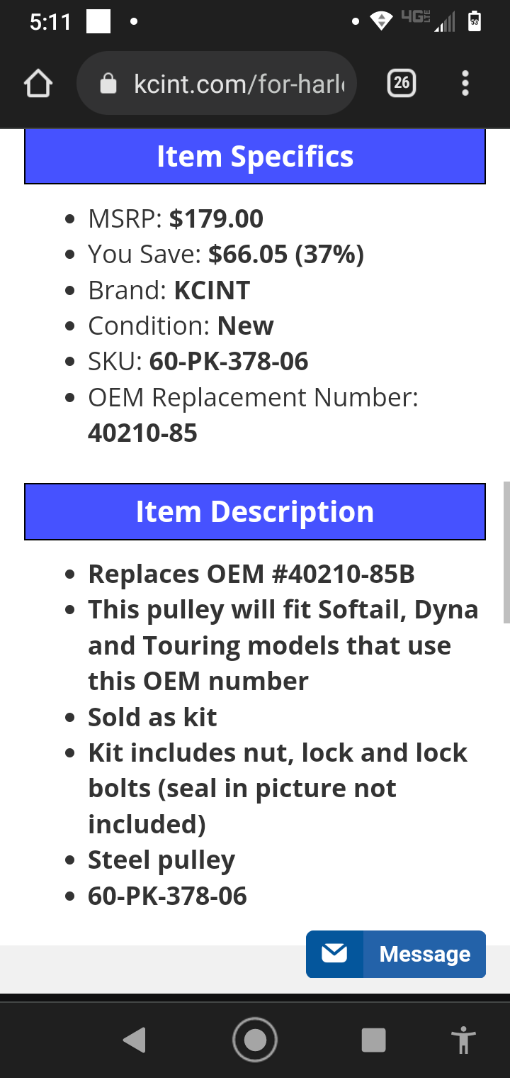

Hoping this front sprocket I ordered is of the updated design? Haven't received it yet but could return it if needed. Has anyone used these?
https://kcint.com/for-harley-softail...t-60-pk-378-06
I hope that will work, 85 and up?? If I remember right, I think the newer main shaft spacers not only differ in outside dia but also in thickness from the old style, therefore having to match the sprockets, I think 2003-2004 is when that change was made

40210-85D is the HD part number for the kit with the updated sprocket components.
If a spacer is not included, just use an OEM for `95 or later.
Don`t reuse the spacer, get a new one.
Received Sprocket. It has spacer included. Says it replaces that exact HD kit. Oh, and it includes the seal that it says will not be included. Plus I previously had ordered one for the 91 main shaft and just yesterday the seal for the 04. Guess I got that covered 3 times over. Lol
