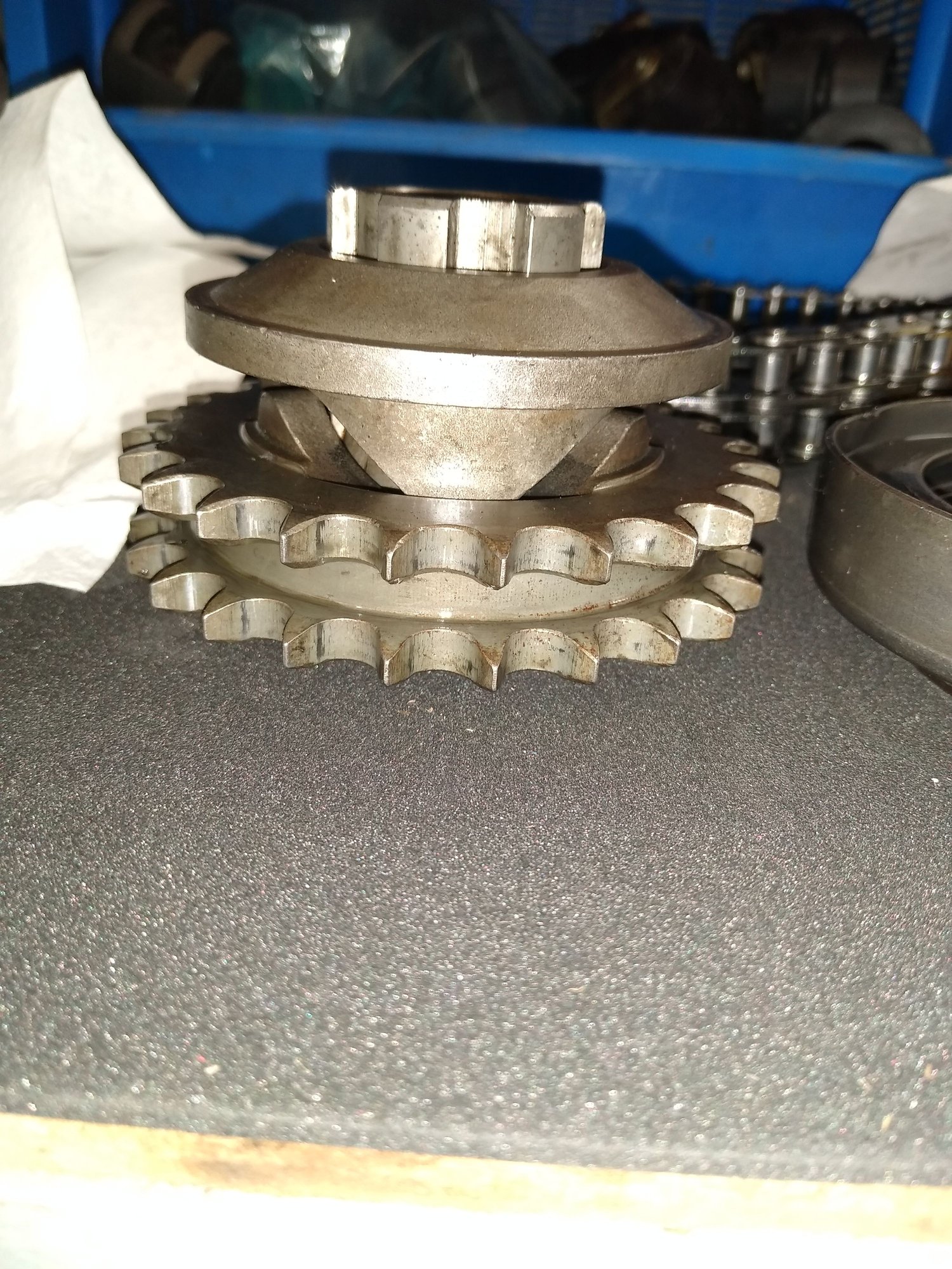

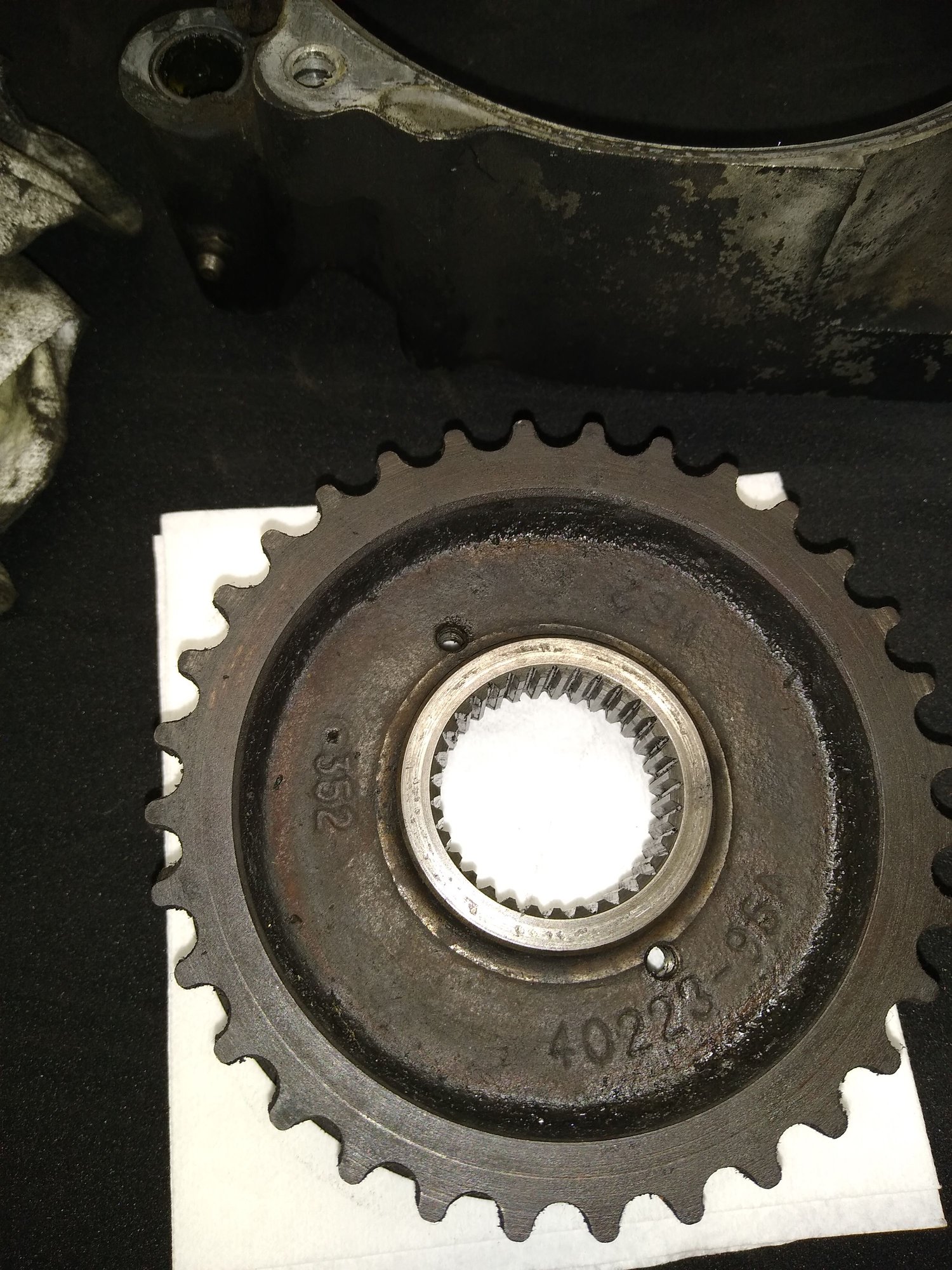

Well we all lost that bet. Sprocket/Pulley is fine unfortunately. Gear set is coming out next for review. Could it possibly be an issue on the compensating sprocket? Or internal issue with that on the motor side?
Old Apr 9, 2022 | 01:31 PM
  #49
DeputyLoud's Avatar
DeputyLoud
Posts: 721
Likes: 18
From: Galesville, WI
Confused. Gear set seems ok too. Where's all the metal shavings or broken components? Waiting for the obvious to appear.
1) I do not understand the compensating sprocket assy ops.
2) Maybe I should go back and review the clutch plate assy. My measurements seemed good tho.
