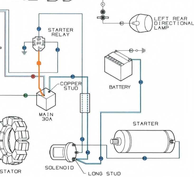

I'd like to try the added relay fix just to see if it helps but not sure if the instructions in the sticky for " dreaded click" will work for my 1988 FLHS. The sticky doesn't specifically mention my year and model, only 1989 FLHS. Can you tell me it the second relay fix would apply to my bike? Thanks, Mike
The added relay will be of no benefit on an `88 FLHS, because the starter relay already has a good source of power for pin 30.
The relay (pin 30) is connected directly to the main breaker silver stud (Orange wire in illustration)
Disconnect the wire and clean the contact surfaces.
Clean the terminals and contact surfaces at the relay and solenoid.
Unplug the connector for the left hand switch harness, inspect and clean the pins and sockets, look for any pins pushed out of the connector.

The '88 is a totally different starter setup than the '89 but the electrics up to the solenoid are the same.
On the '88 the power comes from the starter post to the main breaker, up to the COM breaker then to the main SW. From there, power goes from the main sw to the starter relay (#30) and back to the ACC breaker off of the relay terminal #87a.
When the stater button is pushed, the power from relay post #30 switches to terminal 87, disconnecting #87a and to the solenoid. (yes, it drops the acc circuit when starter activated, not the light circuit)
So you see, the power to activate the solenoid on the early or late starter has to go up and back and thru one (main) switch, 2 breakers and thru the relay contacts. If everything is perfect, never a problem but if there's loss anywhere along that journey or a combination of losses, you will have a problem with the starter activation.
