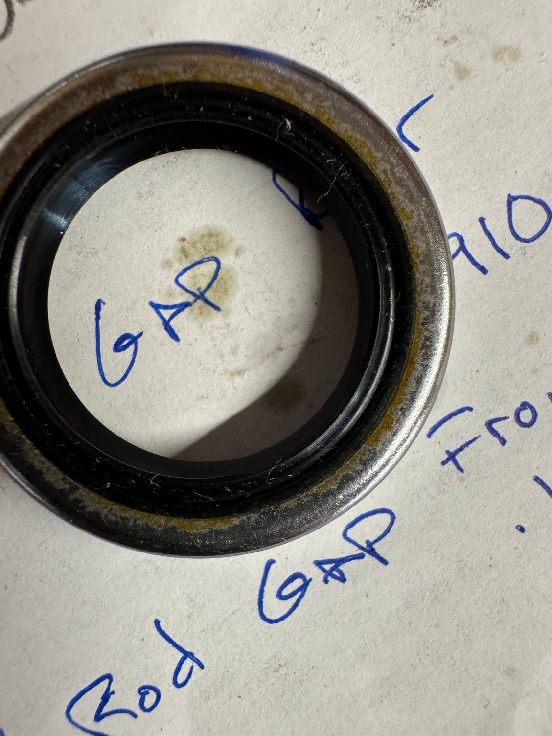

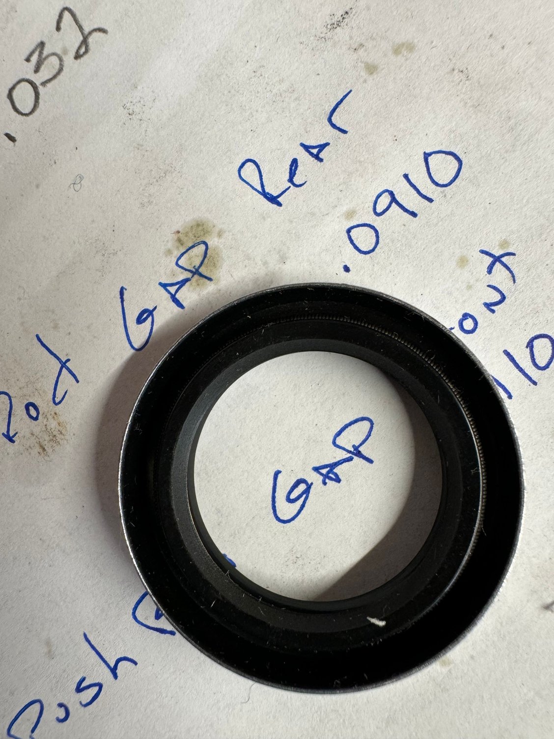

Kit came with this seal… I can’t find it in the manual

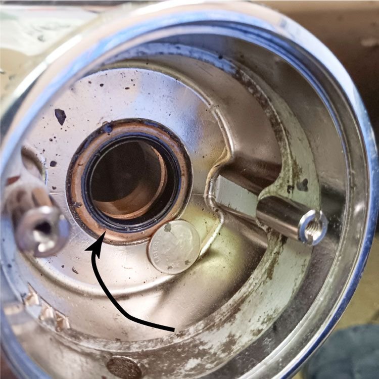

Nosecone seal. Thanks to pgreer, I've even got one handy to take a pic. (Dime is there for scale.)
This is what you've got. I would assume its in the kit on purpose.

Its possible it was put in the kit by mistake and no size reference to guess from - picture has it at about 2 inch center could be a inner primary bearing seal

As Johnjzjz said, without the size reference its hard to tell. Maybe the seal for the camshaft.

It measures at a little less than 1.00”
I agree it’s probably in the kit by mistake. It sure doesn’t go in the stack.

Might be camshaft to cover seal. Does it have any numbers on it?

If he bought a complete engine kit it should have nose cone gasket as well.. the cam measures 1.020" so 0maha is correct..
@GOGOBECK do you have the part number of the kit? Thanks..

Well, this seal didn’t get replaced !! 🤦🏻‍♂️
Cometic: DS172080
I’ve done cam swaps in the past and don’t remember needing to replace this seal.

When your 75 miles from home and oil is leaking out of the cone cap and wire hole you will re think that idea
