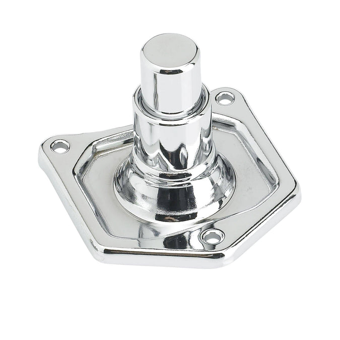

Originally Posted by 08xl1200r
I have a Dyna so I don't know about the oil tank but did have my starter out to rebuild the solenoid recently. I needed to replace the thrust washer and locking tab for the jackshaft bolt too but they were easy to find at a local independent shop. I also opted to install a starter button on the solenoid, it could get me home someday if something upstream (like the handlebar button or the starter relay) fails.
(No help in your case but FWIW the job was MUCH easier on my Dyna with the battery and battery box removed, that was definitely worth the trouble)

And the funny part, if the plunger ring or its contact pads are trashed, manual plunger push button is still is not going to help the problem of getting power to the starter motor itself to spin it.
