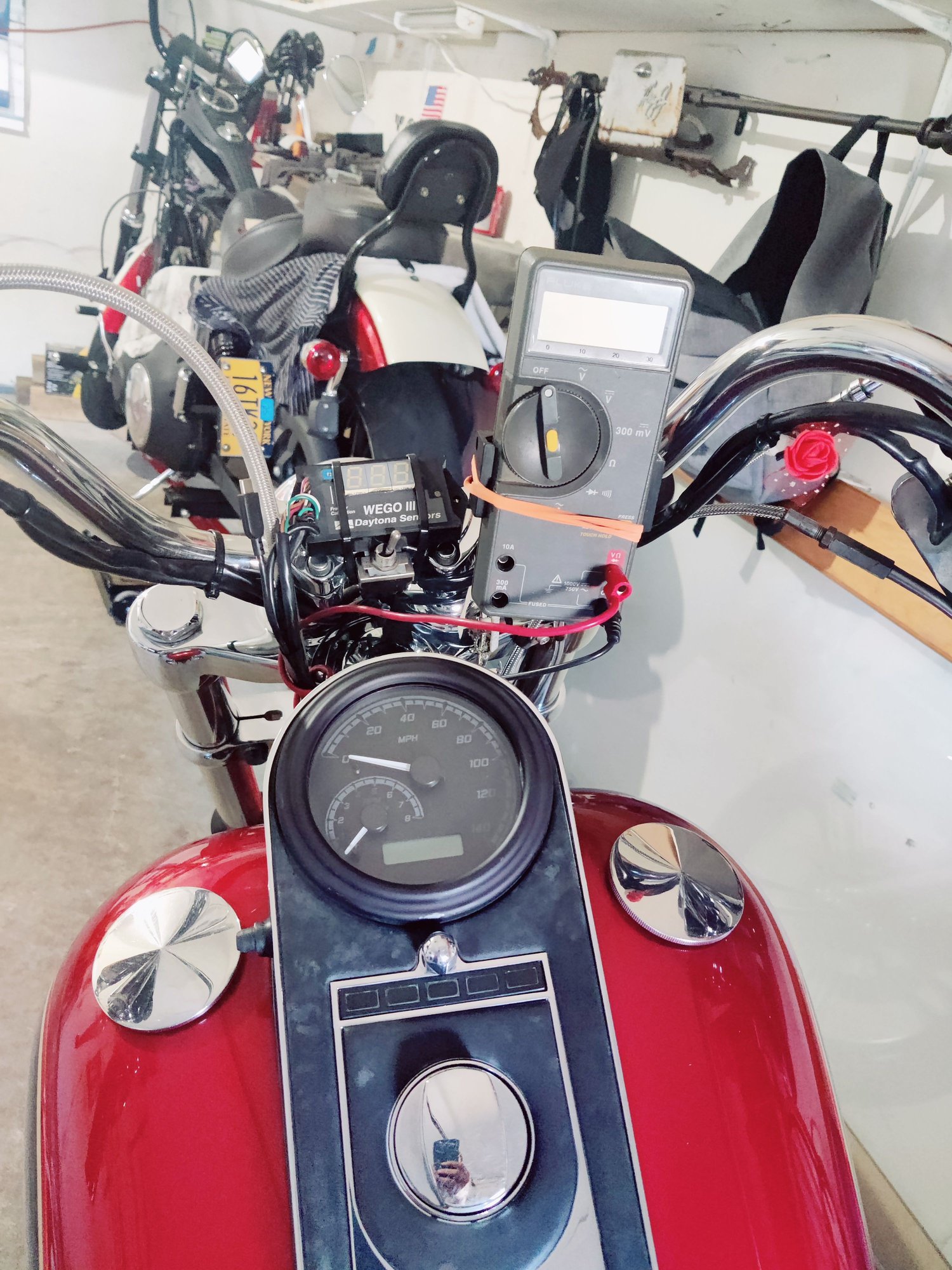

I hooked up my fluke and I'm going to take it for a ride see what I can log for highs and lows It looks cheesy but at least give me some kind of confirmation. But let's put it this way I'm on my fourth ignition module because of what appears to be voltage spikes I don't think there's any denying that four ignition modules will get blown out for some other reason... I don't see it.. I did just order a brand new cycle electric regulator I'm tired of ****ing with this thing I'll give that a shout and we'll go from there..

Well the ride was nice and I saw on the Speedo the voltage fluctuation but never once in the fluke, even checked higher and lows without any indication @t150vej .. Hand in the air.. Maybe @Max Headflow you were correct.. The Dakota Digital Speedo has an issue and not my charging system.. That would be my only resolution and I'm tired.. I'll carry extra parts in the saddle bags and nice on.. I'm pretty beat up with this one.. Thanks you everyone for assisting me..I truly appreciate it.. thanks Rufus, Max, Tony, Ranger 73, Tommy, R2m and every one else..
