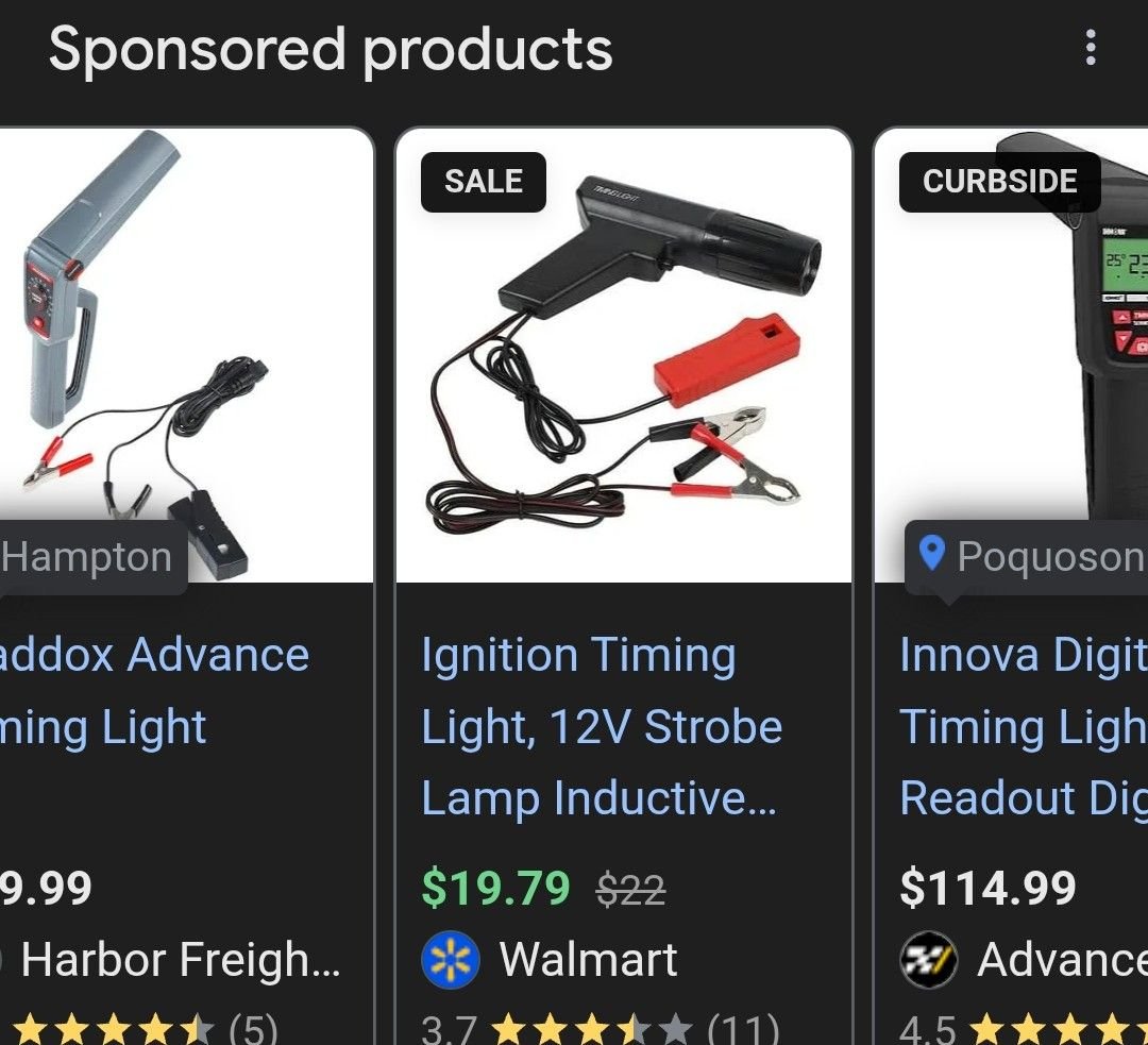

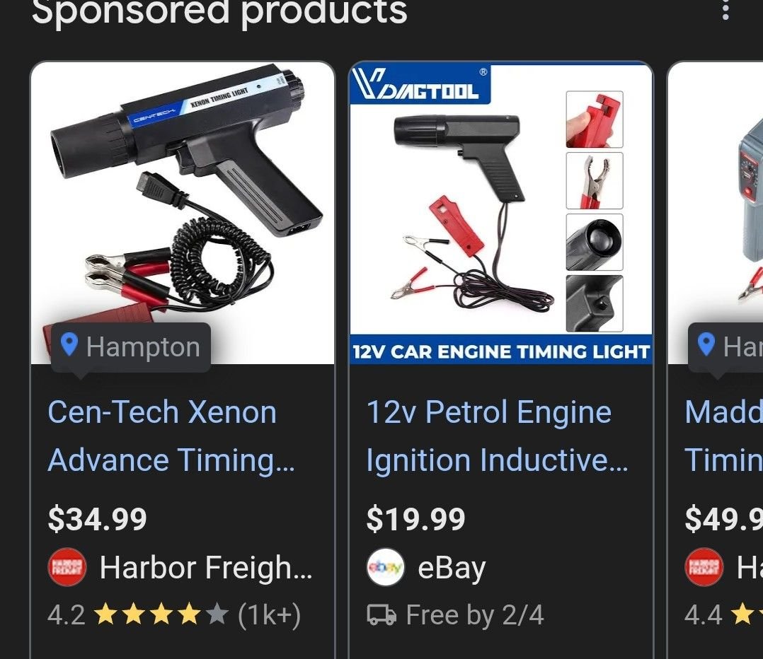

Use the correct tools or pay someone to do things correctly. YouTube is your friend.
Pay the few extra dollars for the adjustable one. But remember, modifications, fuel, elevation, a rainy day will make a little difference in how advance makes it run.
So maybe modify it from the book to real changes, not how it sounds or feels one day.
The advance is not because electricity is slow, it's because the flame is when the sparkplug sets it off.
Set it to the book will make the old girl run best for all conditions..
Make sure below is your year..
