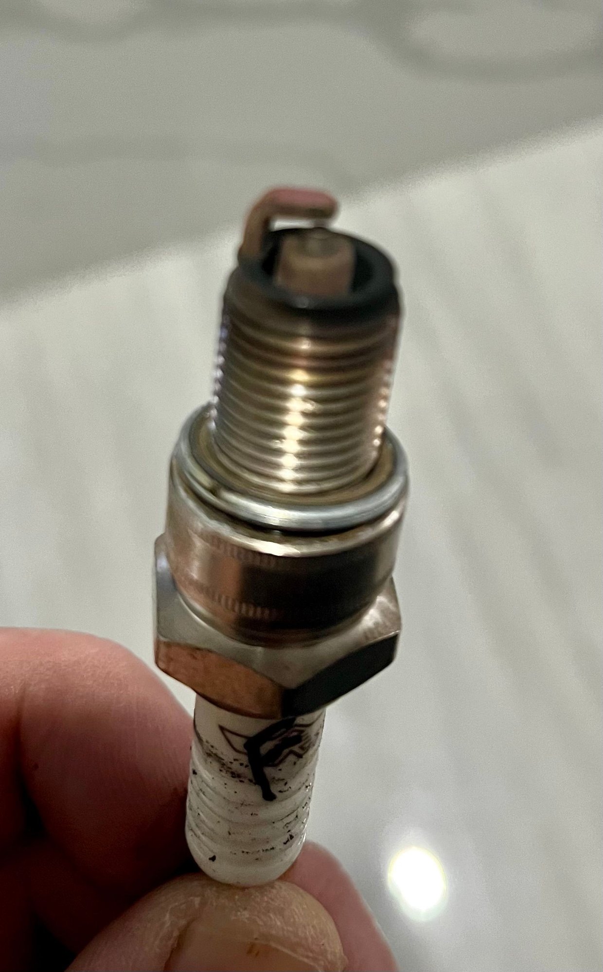

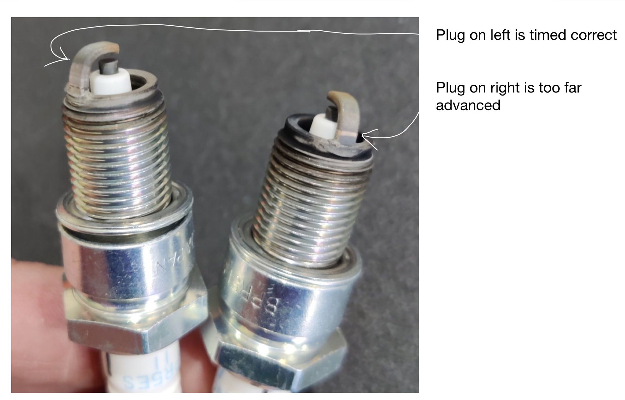

A nice indicator for timing looking at the plugs is if you get the color change right at or just before the bend.
IDK what Gas you are Running...But, The Moose **** here where i live ain't gonna show nothin like that til ya got aluminum "*****" on the plugs!!!
Even our Race gas shows more color than that... is it Methanol??

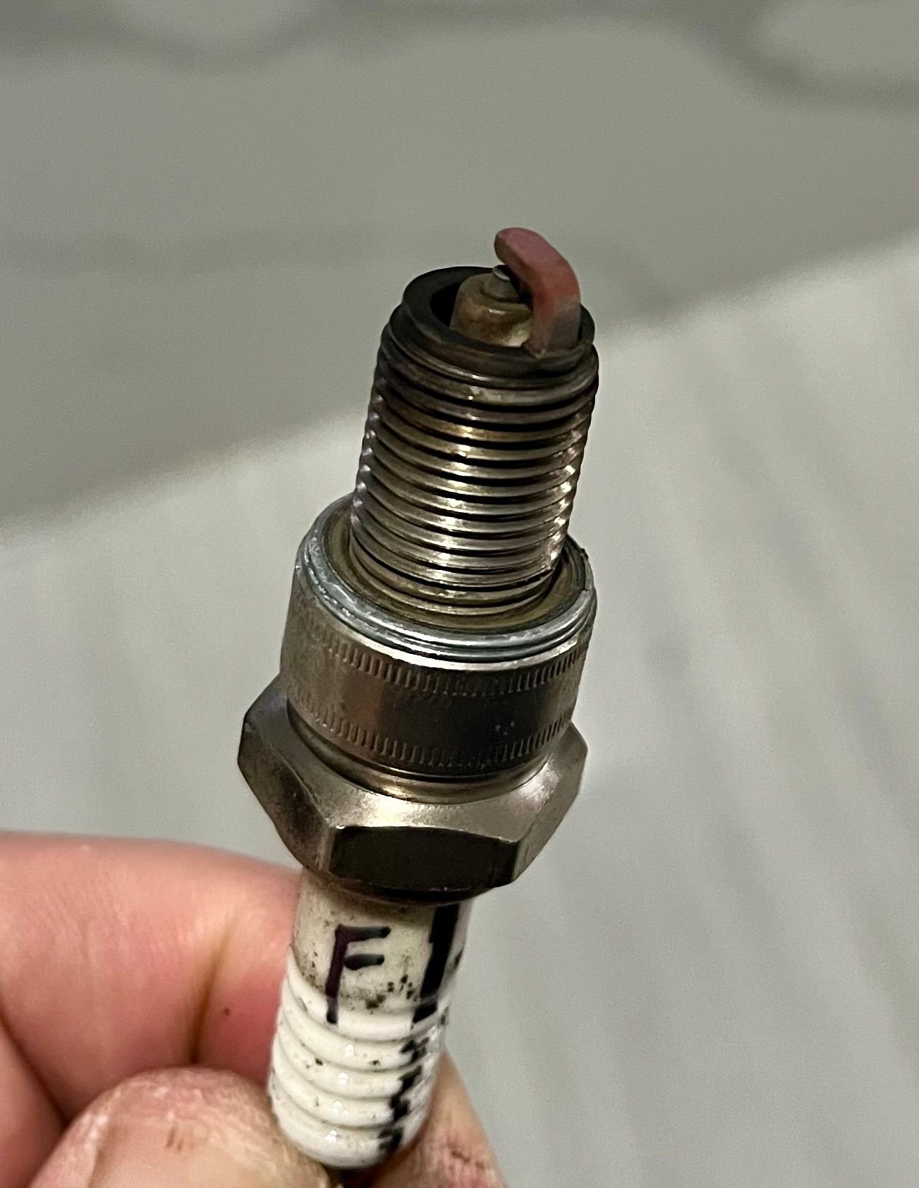

here’s some from my Softail.
the pics I previously posted I grabbed from the internet to show an exaggerated line to convey the timing mark. It’s harder to see from a pic of my personal plugs from this post
Old Apr 8, 2026 | 12:45 PM
t150vej's Avatar
t150vej
Joined: Dec 2005
Posts: 5,403
Likes: 2,605
From: NC USA
Additive or race fuel makes that color. Life was easier when the still used tetra ethyl.
