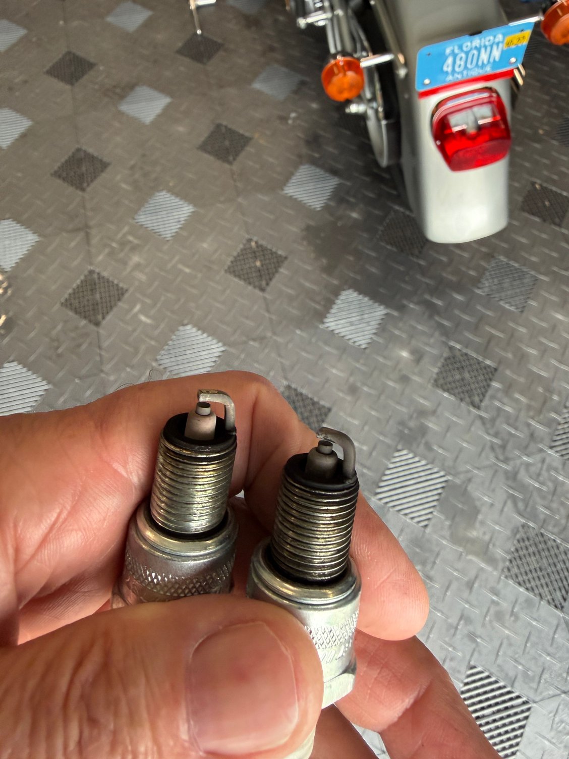

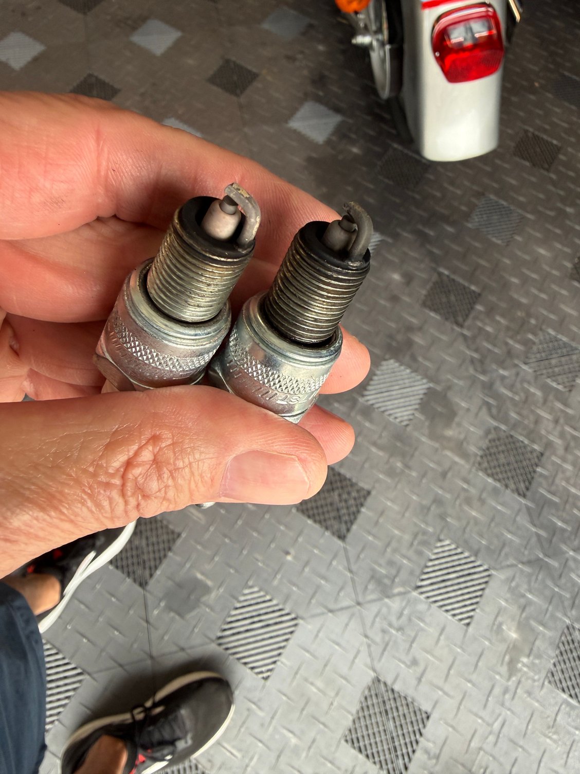

1990 EVO w/17k miles. Completely disassembled to reseal. Cylinders and rings were perfect. All new gaskets and seals. Factory CV rebuilt and has a 185 main and 48 slow jet with the mixture screw out 2.5 turns. Factory air cleaner with most of the back cut out and K&N filter. Stock head pipes and SE Slash Cut mufflers with no baffles. Bike runs excellent with no pinging whatsoever. I run 89 non-ethanol gas. The only issue is once in a while when it's idling and I crack the throttle, it will pop thru the carb. I sprayed brake cleaner around the intake to head gaskets and there is no vacuum leak. New plugs with 300 miles on them. Left=Front and Right=Rear. Thoughts?

Double check your ignition timing, may be too far retarded. Also check the diaphragm in the carb for a pin hole or damage.

That is choke smoke that has not burned off, but it almost has on the front.
Put 2 new plugs in, them remove them. Re-install the old ones, ride 10-15 miles and swap plugs. Ride 100+ miles, same day, then take a picture.

Brand new rebuild kit with new diaphragm. I will check the timing as it was a bitch to set but I thought I got it correct. I also want to install a new vacuum line on the VOES.
Doing this will eliminate the "choke smoke" on the plugs to get an accurate reading on the plugs when the bike is warmed up. Correct?
Yes sir!

Looks like there's shadowing on the rear plug, so hard to tell.. Front looks good.. Definitely need more timing.. on your cam position sensor you will see timing lines, rotate the CPS 2 lines clockwise and install new plugs like Rufus mentioned.. NGK BPR5ES-11
