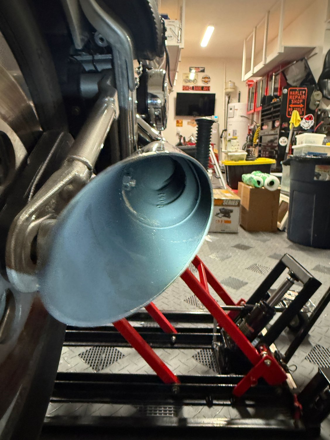

1990 EVO w/17k miles. Completely disassembled to reseal. Cylinders and rings were perfect. All new gaskets and seals. Factory CV rebuilt and has a 185 main and 48 slow jet with the mixture screw out 2.5 turns. Factory air cleaner with most of the back cut out and K&N filter. Stock head pipes and SE Slash Cut mufflers with no baffles. Bike runs excellent with no pinging whatsoever. I run 89 non-ethanol gas. The only issue is once in a while when it's idling and I crack the throttle, it will pop thru the carb. I sprayed brake cleaner around the intake to head gaskets and there is no vacuum leak. New plugs with 300 miles on them. Left=Front and Right=Rear. Thoughts?

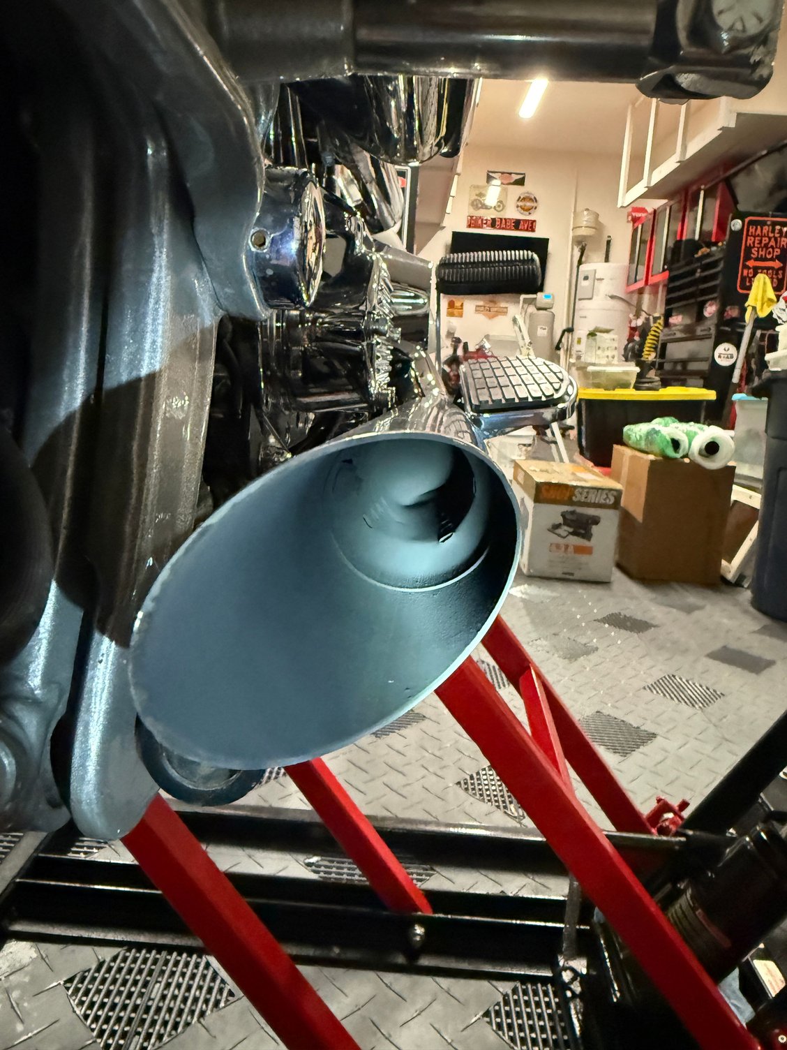

Sorry to leave you hanging @BigMike and thanks for the second set of photos. I can't swear I see a timing mark(s) but I can tell you, that's what the plugs will always look like, black.
You do need to run a 45 but you can't with the open pipes. I tried the same thing with a SE3 (EV27) Tour pipes and SE mufflers but they did have baffles that were of no use without packing and the front diverters were cut out. Like yours it ran Ok, got decent mileage but the plugs were al\ways black until I changed baffles so I could use a small amount of packing.
Good news is, you have the best factory cam "L" and a round float carb meaning it has an N72S needle which is a good one. So if you ever decide to quieten down slightly with baffles and a small amount of packing, you can run a 45 and everything will tune out better.

I haven’t spent a lot of time with CV.. however, I’d be inclined to just install a 1/4” inch bolt at the end of the pipes/mufflers, install a 45 jet and leaving everything else. .40 cents and drill a little hole is all it takes to find out. Your running a richer jet to mask a different problem in my opinion.
With an E in that situation, I bet it would end up a .28 or maybe a 29.5, but you could run smooth as silk with open pipes and a ev 27 if timing is right with TTI’s or lollipops in there. And don’t know with cv, but with E your float might be set to low, leaning and you’re compensating with a larger jet.
I was fiddling with my buddies 98. EV27, CV, SE mufflers same as you… finally convinced him to go 10:1 & an E (due to my lack of tuning ability with a CV) and he went V&H baffles, no packing and I put in the thumb screw 3/4 of an inch from the end and the bike is super smooth. .28/72

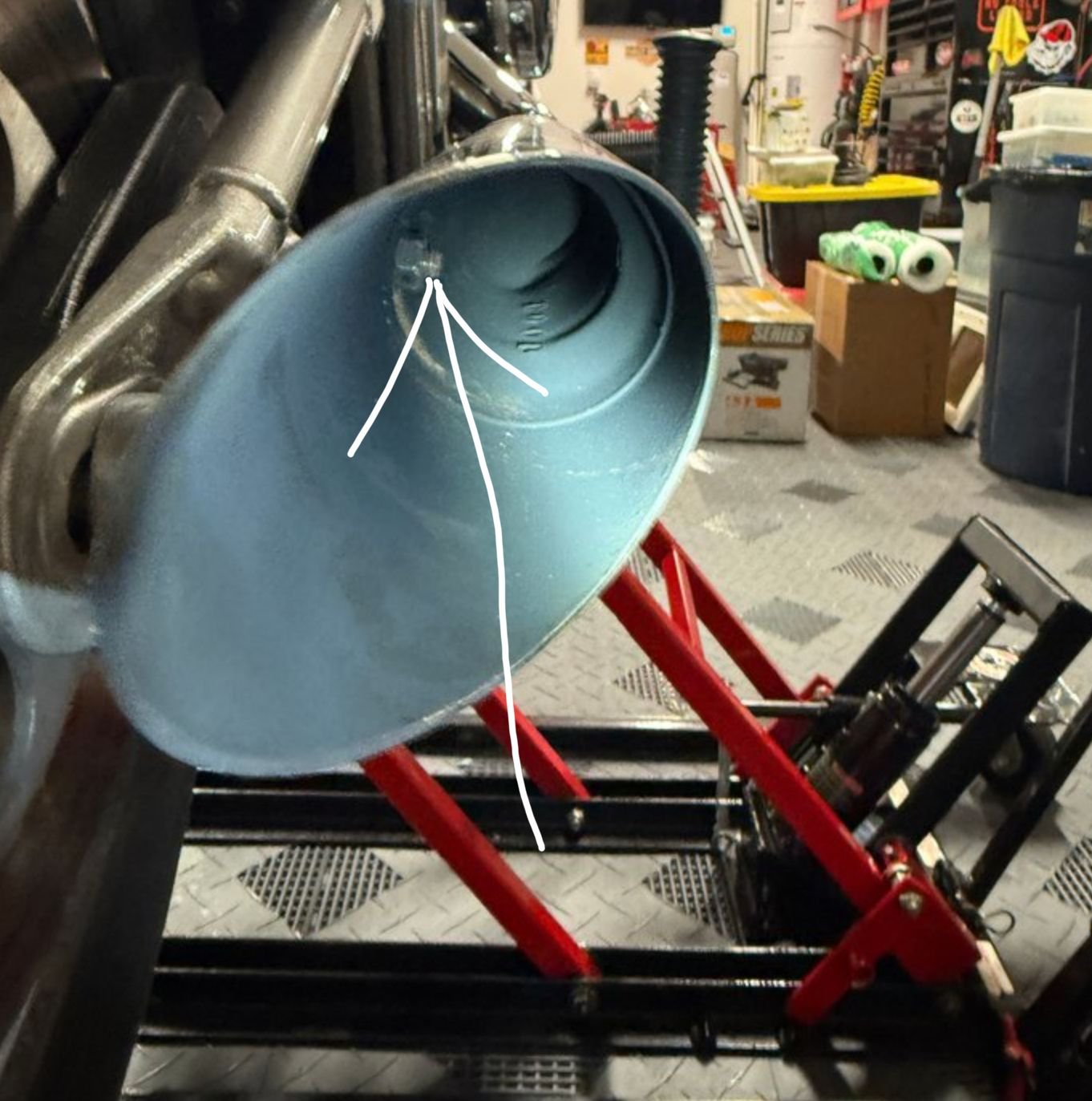

I bought the mufflers on eBay and wondered why they were so cheap and in great shape - they didn't have baffles. I'll see if I can find some but might have to look for another set of mufflers. The bike had drag pipes on it when I got it.
EDIT: I just double checked the mufflers and they do have baffles which means I got a smoking deal for $75 shipped. Let me know what jets you would run and I'll install them.

Take the baffles out (hopefully you can), measure the OD to the smaller OD and order -"ceramic fiber fabric" off ebay. Either 3/4 or 1/2 should be just right and do not overlap it.
.Don't use fiberglass, it'll burn out in 50 miles. Start with that and we'll see how it goes.

Sorry this wasn’t directed at me and there are a lot of chefs in the kitchen…
But just remove the bolt that holds the baffle… go to the hardware store and buy two bolts that is long enough to almost touch the other side when tightened. Put in a 45 jet, tune your mix screws and I bet your problem is 90% fixed…
if so, buy the largest size Thunder Torque insert from DK Customs and then your problem will be 99% fixed.
