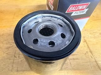

Just an FYI, there is still at least one company making Evo spec oil filters in the USA.
Baldwin BF 1413.
Rock auto carries it as a Hastings LF576, but the filter they sent is a Baldwin BF 1413.
Hey Marty @Racepres , you`ll be happy to know these filters do not have anti drain back valves.
Link Rock Auto EVO Oil Filter

Great News... I am getting by with the Wix, still...but I prefer Made in USA ..Certainly will Not run anything with an ADBV..unless I had a Machine with the Filter in the Feed Side...(think 5-speed Sportsters and Much Newer Big twins) I run the Baldwin B474 in the old 4-speed FXWG with Evo Engine.. ...Oh...wait...same filter on the '84's (4-speeds) the one under the swing arm... Anyway...thank you, another Option that I did Not know about!!!

That's good info..I was thinking of using that style on my Twinkie but didn't know if any one made one.... With the S&S plate and pump I don't think I have to worry about it..
