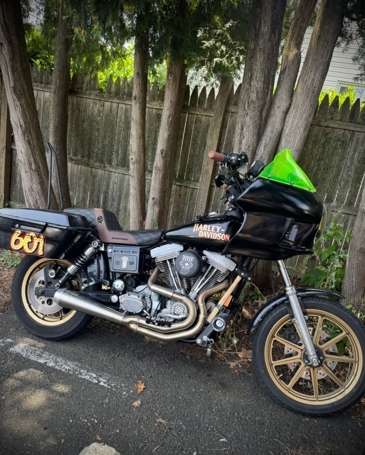

I’ve got a 96 FXD, currently running an ev27 in. I got a killer deal on a set of .020 over jugs with 10:1 pistons. And figured while I’m tearing it down anyway, I might as well throw in a bigger cam and springs if the heads are off. My question is, can I run a spring kit to accommodate the lift of something like the DM580 cam without having to modify the heads to fit the springs? I’m trying to learn how much I can do on my own. But any guidance is appreciated.

EDIT: OP, nice looking scooter!
