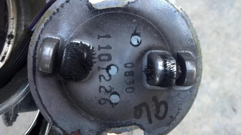

I pulled out the module this morning and flipped it over. I can't remember what these are supposed to look like on the back, but I doubt it's supposed to look like this:
Reckon this is my problem?
Also, I noticed I can rotate my rotor cup by finger. The bolt that runs through it isn't tight so that's another problem. I'm not sure which came first, the rotor cup coming loose or the module magnets disintegrating.

Actually the magnets may be just fine. Looks like they're just covered by metal filings possible having to do with the loose bolt.
This would cause the timing to shift.
If your able to reposition things and bolt it down, it may work just fine. Maybe some locktite on the bolt would help.

As you can barely see in the picture, the magnet on the right is completely closing the gap that the rotor cup needs to pass through. The other gap is flush all the way through. I'm not sure if the magnets are supposed to be protruding into the gap at all.
Either way, the reason the rotor was spinning freely is because the indexing tab broke off. There's no way for it to stay timed. I'm not sure what caused what, but both are broken and will have to be replaced.
