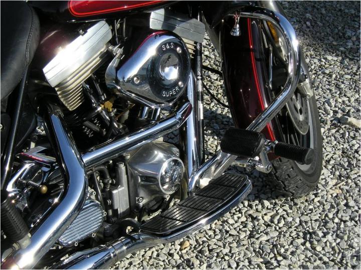

After rebuilding my solenoid I found it still jumped out before starting. This got worse as time went on and I couldn't afford a new starter so drilled a hole in the end of my solenoid cover and chrome cover and put a spring loaded shoulderbolt through with a fancy brass ****. Bolt head is inside the cover. Used this on that same starter for another 8 or 10 years before selling the bike. Basically the starter motor never failed it was the solenoids ability to engage the starter.
