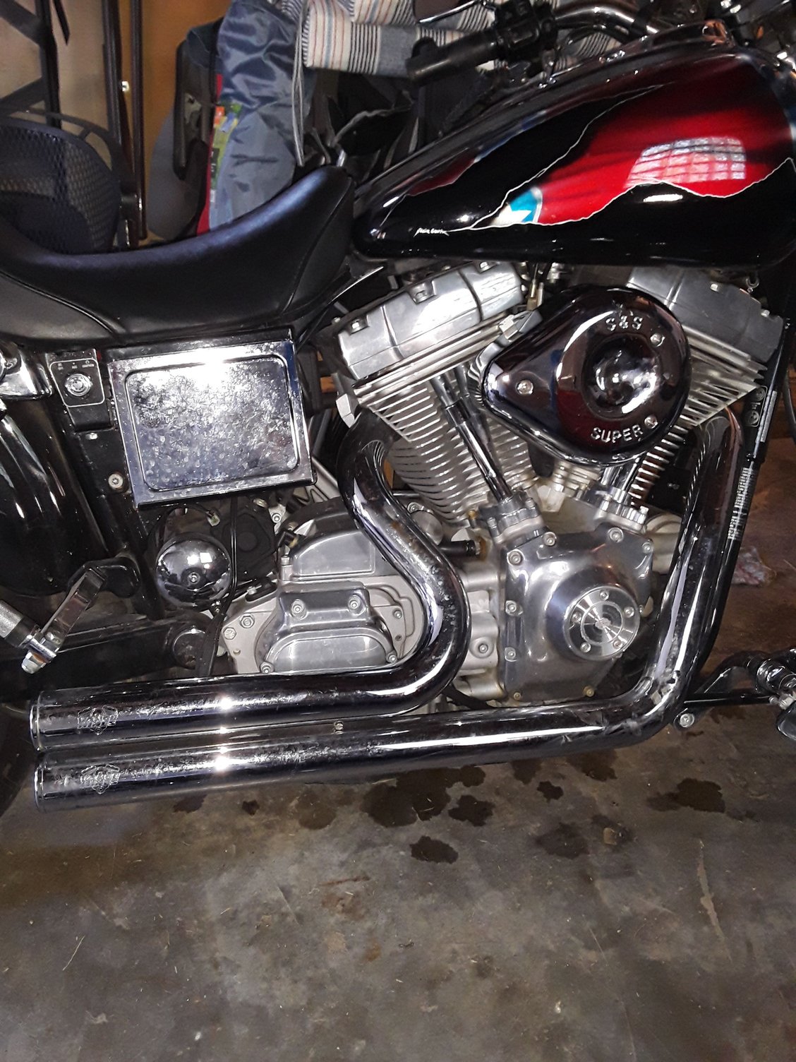

Can anybody help me figure out what exhaust setup I have here?
This is my first bike, and I just got it used.

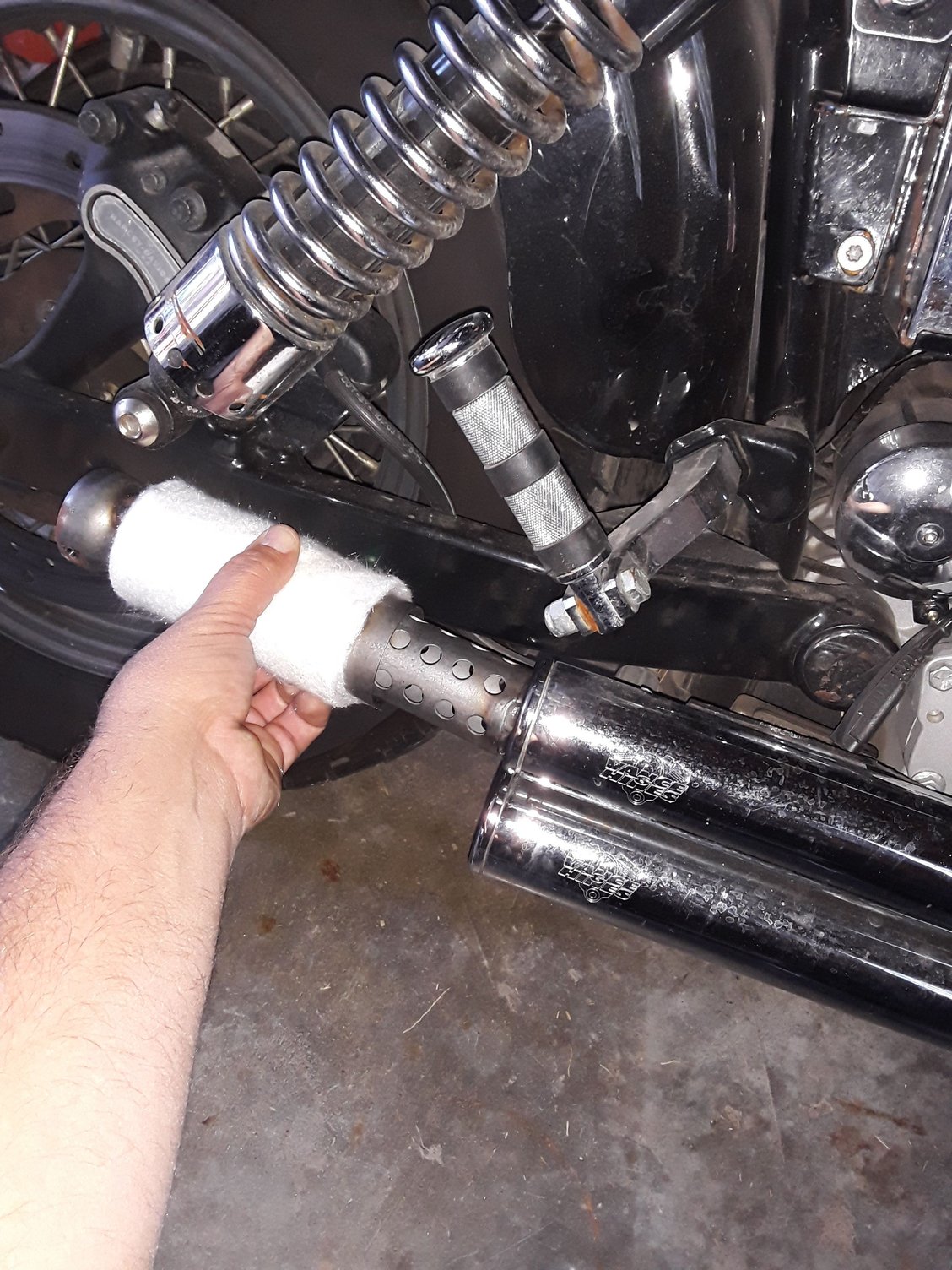

I found some site that suggested quiet baffles, so I ordered some, for what I thought were Vance&Hines short shots. Nope... the baffles I got were way too big.
I don't even know where to start at this point. I just know that I'm not in love with the sound that I have.

Vance & Hines, Short Shots.

That's what I thought! But here are the quiet baffles they sent me for V&H shortshots.
Way too big.
Are there different sizes?

Posts: 9
Looks like baffles for the Long shots, or the slip ons.
I appreciate it. They are definely labeled as "quiet baffles for shortshots".
I know for sure that they are going back.

A new system is a good idea. Putting the quiet baffles on those short shots won't make it much quieter. You're still dealing with an exhaust that is robbing power when you might be more interested in something that improves the power.

Those are the original short shots, they probably sent you baffles for the newer staggered short shots. Don't buy V&H again, if you want something similar that will be of better quality have a look at the Bassani Fire Flight or Pro Street Turnouts. If you want a really really good pipe look into the Fat Cat from D&D....
