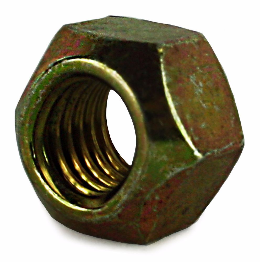

Hard to tell. But elliptical locks aren't round on one side of the nut. This allows tension to always be squeezed. These are all over jet engines. I don't worry about getting the FAA-PMA verified ones and just source them from McMasters.

The bottom hole is round. Where the stud starts into the nut. The hole where stud will protrude is oval. Imagine putting a nut in the vice and only squeezing the top hole shut. When installed. This oval hole becomes round and there is constant squeeze pressure on the bolt. Stock pic from net. Look at 10 oclock to 4 oclock compared to 90 degrees. Can you see how it is oval?
I can my man.Thanks for clearing it up.
