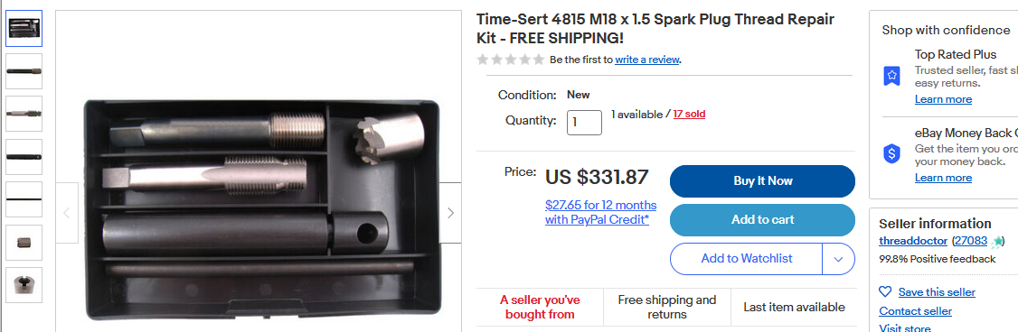

A possible solution. Kinda pricey

Well after taking my heads to a good machine shop it’s wasn’t the threads it was the decking for the plug seating .
since plug don’t seal at the threads like pipe threads the landing for the plug needs to be tire,
these aftermarket were not.
