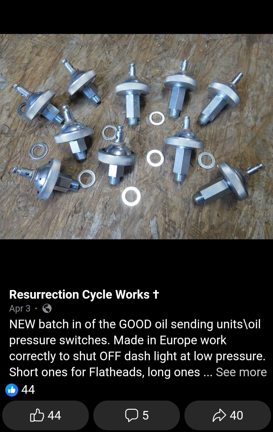

Old Dec 7, 2024 | 06:49 PM
cp45mec's Avatar
cp45mec
Joined: Jan 2022
Posts: 40
Likes: 13
From: VA
So there are some good ones out there, they are made in Europe you have to look at the insulating washer. On the bad Indian made ones it is black plastic on the good ones it is brown.
