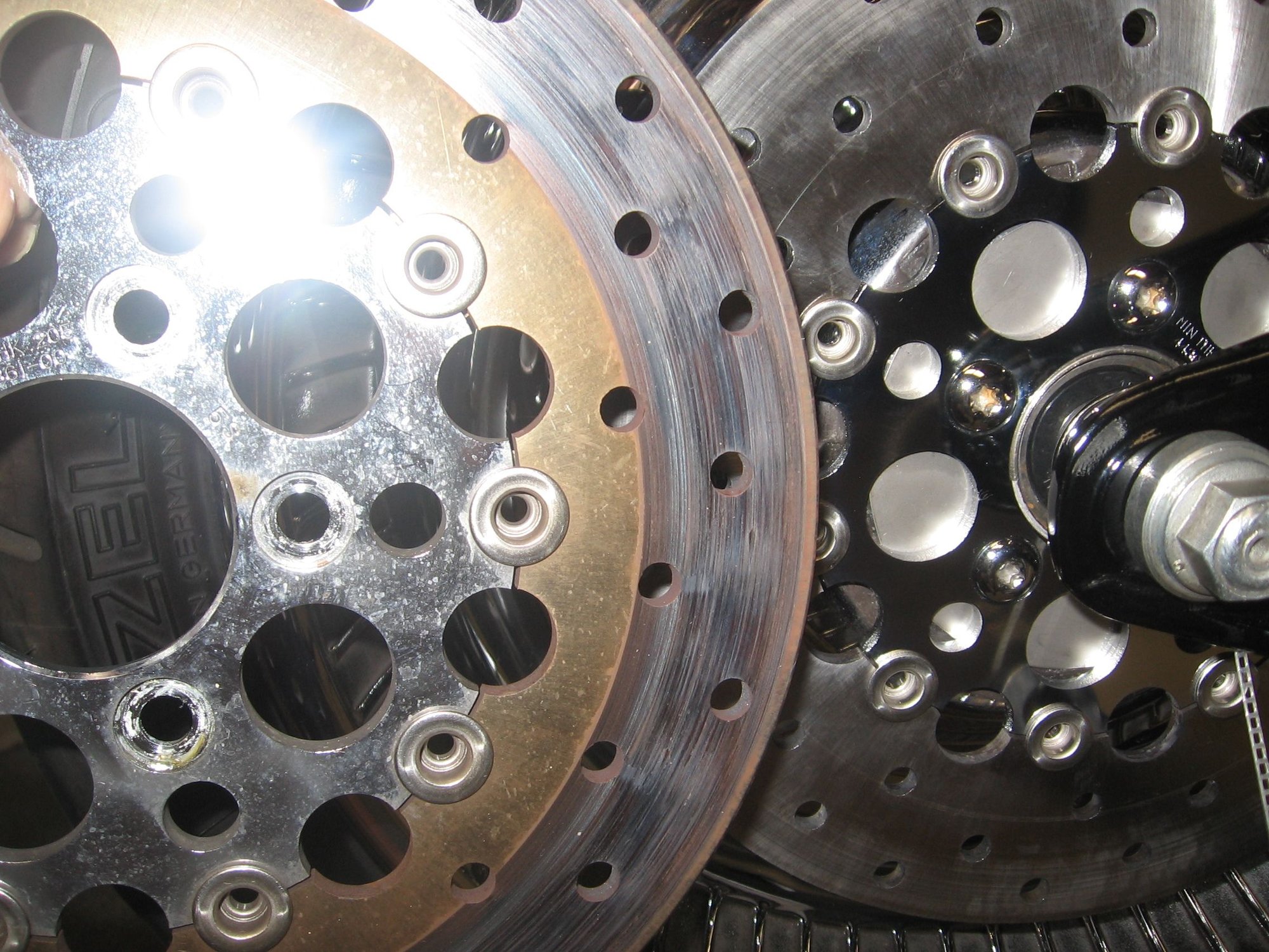

Several (6-7) years ago I was on my way to work doing 75mph. The bike was slowing down even though I was rolling on the throttle. No matter how much throttle I gave it the bike just kept slowing down. Got it to the shoulder and could smell a 'hot' smell. Looked at the rear brake and it was glowing red. For some reason the rear caliper had locked up.
After sitting there for about 15 minutes waiting for the truck, I tried pushing the bike and it rolled just fine.
If this is what happened to you then the noise from the primary was probably caused by you trying to force the engine to overcome the rear brake. Compensator rattling maybe.
I didn't try to fix anything as I didn't want to risk it happening again. Besides, it gave me an excuse to add some chrome. I replaced the caliper, rotor, and pads. No problems since then.
heated rotor on the left, new on the right.

the red spot that you had in rotor, I have almost the same only mine was like narrower than yours. about 1/4 of inch or so. you are right about the noise from tranny being forced to roll the bike with lock up wheel.
